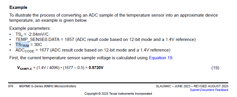

Currently I'm running example adc12_internal_temp_sensor_mathacl on launch map MSPM0G3519.
The internal temperature result is following, and I think it's not correct:
Can you help me to check this point again ?
Another question is that according to the datasheet of G3519 ,it will use internal VREF 1.4V as voltage reference
But what I actually observed in the example code is using VDDA/VSSA as voltage reference. So which one is correct ?

    To use the calibration constant in the factory region of memory, the 1.4V reference should be used. You can scale the constant based on a 3.3V reference and your readings will be significantly more accurate (but still less accurate than using the 1.4V reference).

    What will happen if I access directly to FACTORYREGION->TEMP_SENSE0 without using your API. Does this have any bad effect in the system?
    Or should I use the provided API from sample source code?
    The reason for asking this is because include code for factory region will cost more ROM in our project
  • Hi Khanh,
    Accessing TEMP_SENSE0 directly is valid and will not cause issues if FLASH_ERR_01 is handled properly.
