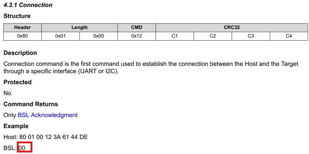

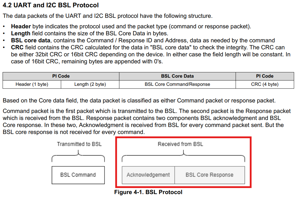

I'm a bit confused about which byte in the BSL response to read to get the proper BSL Acknowledgement.
According to the following section in the "MSPM0 Bootloader User's Guide", the acknowledgement seems to be the first byte within the BSL response.
As is shown in the following examples:
However, in the following SDK BSL code example, the Host_BSL_getResponse() function is written to check the byte[4] of the response for the acknowledgement instead of the first byte.

Am I safe to take the first byte of the response as the Ack byte? or do I need to follow the implementation of the above mentioned function?

  • Hello Kyungjae,
    Yes, I think you are correct.  BSL ACK always before Core response.  Should be returning byte [0] in my opinion as well.
    Which SDK example is it?  I'll submit a request for an update to the software team.
