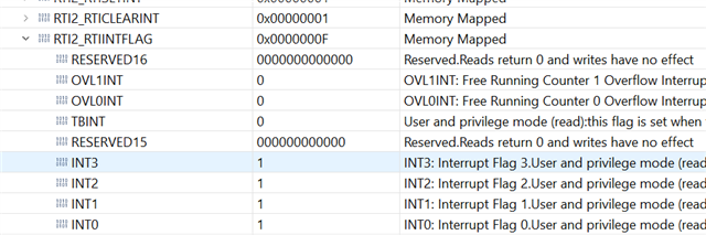

    the below images contains state of INTflag when my rti stops, here rti1 and rti2 gets stopped.

    I believe unconfigured compare blocks 1, 2, 3 are generating spurious interrupts that never get cleared, causing interrupt controller lockup. Clear and disable all compare blocks at initialization, then only enable the one you're using.

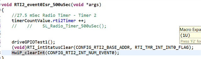

  • Can you please share your ISR code?
    Shaunak
  • HI, please find isr below.
    Gopala Lakshmana Swamy
    I believe the issue is that we are only clearing INT0, not all flags, Try to clear all the possible flags instead of just INT0.

    1) i made changes as you suggested in my isr, but still facing same issue.
    2) in my actual isr code, in 1ms timer i'm setting different flags and based on it i'm calling my functions. can i do it like that. and is it possible to hold my isr for extra time than iactual time it is taking.
