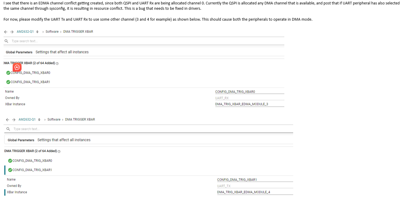

Hello TI team,
In our project, we need configure QSPI&GPMC&UART to EDMA mode. But there is the conflict of DMA channel usage. So the UART transaction failed. This problem is solved by modifying the UART Tx and UART Rx to use some other channel (3 and 4 for example) . The screenshot below is the answer of this question.

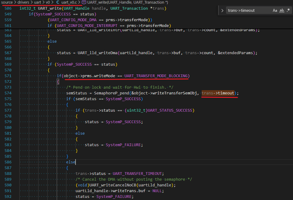

  2. Is there configuration parameter about UART or EDMA time out in SysCfg? If the UART transaction is not happening, how can we identify if the transaction is time out? Besides, I found that the initial time out threshold of semaphore is forever in SDK, can I change this time out value to a reasonable time? And if I configure the UART read&write moede to "Callback", this time out in transaction parameter seems will not be used. So it seems that configuring the time out parameter will be a better way to solve my question.
    UART_Transaction.timeout is NOT used in callback mode (as you correctly observed). The UART_read()/UART_write() will return immediately. You must implement timeout using SemaphoreP_pend() with timeout parameter yourself. This is same as needed for implementing (1).
    // In callback mode:
    int32_t semStatus = SemaphoreP_pend(&gUartBtReadDoneSem, ClockP_usecToTicks(timeoutMs * 1000));
    if (semStatus == SystemP_TIMEOUT) {
    // Transaction timed out - no data arrived in time
    DebugP_log("UARTCTRL: Read timeout! Expected %d bytes\n", gUartReadTrans.count);
    UART_readCancelNoCB(gUartHandle[BT_UART]); // Cancel stuck transaction
