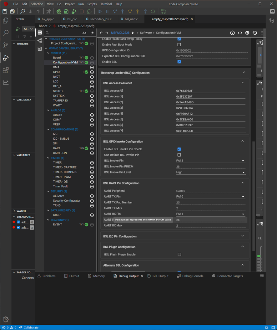

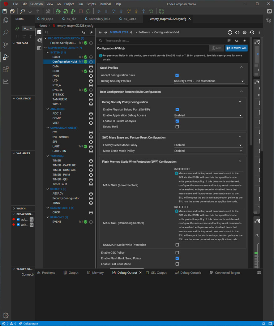

     * These arguments were used when this file was generated. They will be automatically applied on subsequent loads
     * via the GUI or CLI. Run CLI with '--help' for additional information on how to override these arguments.
     * @cliArgs --device "MSPM0L222X" --part "Default" --package "LQFP-64(PM)" --product "mspm0_sdk@2.09.00.00"
     * @v2CliArgs --device "MSPM0L2228" --package "LQFP-64(PM)" --product "mspm0_sdk@2.09.00.00"
     * @versions {"tool":"1.25.0+4268"}
     * Import the modules used in this configuration.
    const Board         = scripting.addModule("/ti/driverlib/Board");
    const GPIO          = scripting.addModule("/ti/driverlib/GPIO", {}, false);
    const GPIO1         = GPIO.addInstance();
    const NONMAIN       = scripting.addModule("/ti/driverlib/NONMAIN");
    const SYSCTL        = scripting.addModule("/ti/driverlib/SYSCTL");
    const UART          = scripting.addModule("/ti/driverlib/UART", {}, false);
    const UART1         = UART.addInstance();
    const ProjectConfig = scripting.addModule("/ti/project_config/ProjectConfig");
     * Write custom configuration values to the imported modules.
    Board.configureUnused             = true;
    Board.genPeriphPinFile            = true;
    Board.genResourceCSV              = true;
    Board.peripheral.$assign          = "DEBUGSS";
    Board.peripheral.swclkPin.$assign = "PA20";
    Board.peripheral.swdioPin.$assign = "PA19";
    Board.genFileMod.$name            = "ti_driverlib_BoardPins0";
    Board.genFileCSV.$name            = "ti_driverlib_ResourcesCSV0";
    GPIO1.$name                   = "GPIO_GRP_0";
    GPIO1.associatedPins[0].$name = "GPIO_TEST_OUT";
    NONMAIN.nonmainWarning      = true;
    NONMAIN.flashBankSwap       = true;
    NONMAIN.bslDefaultInvokePin = false;
    NONMAIN.bslInvokePinLevel   = 1;
    NONMAIN.bslAltConfig        = true;
    NONMAIN.bslAppVersion       = 0x1;
    NONMAIN.bslAltAddress       = 0x2023;
    NONMAIN.bslInvokePin        = "PA12";
    SYSCTL.SYSOSC_Freq        = 4000000;
    SYSCTL.HFCLKSource        = "HFXT";
    SYSCTL.peripheral.$assign = "SYSCTL";
    UART1.$name                    = "UART_0";
    UART1.enableFIFO               = true;
    UART1.enabledInterrupts        = ["BREAK_ERROR","FRAMING_ERROR","NOISE_ERROR","OVERRUN_ERROR","PARITY_ERROR","RX","RX_TIMEOUT_ERROR"];
    UART1.peripheral.$assign       = "UART0";
    UART1.peripheral.rxPin.$assign = "PA11";
    UART1.peripheral.txPin.$assign = "PA10";
    UART1.txPinConfig.$name        = "ti_driverlib_gpio_GPIOPinGeneric0";
    UART1.rxPinConfig.$name        = "ti_driverlib_gpio_GPIOPinGeneric1";
    ProjectConfig.migrationCondition = true;
     * Pinmux solution for unlocked pins/peripherals. This ensures that minor changes to the automatic solver in a future
     * version of the tool will not impact the pinmux you originally saw.  These lines can be completely deleted in order to
     * re-solve from scratch.
    GPIO1.associatedPins[0].pin.$suggestSolution = "PB13";

    Is it OK to program the same BCR cfg. and BSL cfg. again for each time after building modified 2nd BSL???
    If not, please tell me the reason.
    I just wanna know the reason that the message "NONMAIN contents corrupted" was shown on CCS.
    Flash (nonmain + main) needs erase before write (programming)
    nonmain Flash also needs to erase first.
    Some times will show this when there is no write after erase.
    ==>No.
    "BCR" is NOT in nonmain but only in the ROM as you mentioned above.
    Do you mean "BCR cfg."???
    if so, it might be in the same sector of flash memory even though it is at tails of the flash,
    and it might be erased at the same time because flash memory should be erased only for each sector.
    Is there a risk that BCR cfg. and/or BSL cfg. would be erased at the same time if those exist at the same sector of BSL???
    At the tail of nonmain BCR/BSL config.
    Like: 1.6.17 BCCONFIGCRC Register
    Boot code that need BCR config in nonmain is in ROM
    What do you mean by "addr=0x0"??? Do you mean nonmain area???
    nonmain address is not 0x0.
    0x0 is main flash, some error will seen after only 2nd bsl programmed because the empty of 0x0.

    alternate BSL should be the 2nd BSL in "C:\ti\mspm0_sdk_2_09_00_01\examples\nortos\LP_MSPM0G3507\bsl".
    But for your issue, here is the recommended method:
    Try to follow the User's Guide MSPM0 NONMAIN Flash Memory Configuration Guide to test your nonmain modification function, and try to read it back based on Uniflash.
    Then you can start 2nd BSL programming based on demo code.
    Once 2nd BSL is programmed successfully, you can download your own app code(The flash address occupied by 2nd BSL needs to be excluded in linker file)
