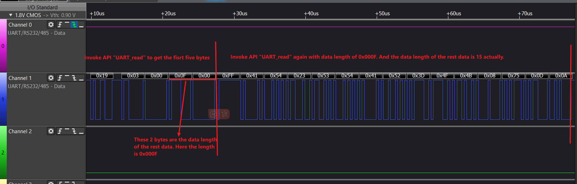

Hello TI team,
I' m trying to receive one response of external device via UART by invoking API "UART_read" twice under UART DMA mode. Because the data length of external device is varied, and the fourth and fifth bytes are the data length of current response. So I want to read the first five bytes and calculate the data length of this response, then I will read the rest bytes of this response. For now, I found that I can't read the rest bytes when I invoke the API  "UART_read". Please help me to implement this feature, Thanks for your help.
The screenshot below is an example of the external device response.

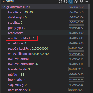

The screenshot below is the UART configurations in our project.
    Could you please share the code of your current implementation and what error you're seeing with it?

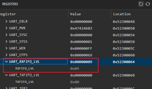

    The screenshot below is my current implementation. And I set a breakpoint at the second "UART_read", the length of rest data is same with the example above. The error is that the second "UART_read" will not return. UART configurations are in the text content above.
    Another phenomenon I found, if I click the refresh button in register window the UART_RXFIFO_LVL register value will decrease to 0. Is this reasonable? In my opinion, after the first UART read finished the EDMA will not copy data from UART RX FIFO. So why this  UART_RXFIFO_LVL register value will decrease to 0? Is this related to the issues about the second  "UART_read" will not return?
    Is it possible to have a call to further debug this?

    I see GPMC memory address in the 2nd read, looks like there is still some interference with GPMC and UART DMA configurations. Could you please check?
  • Hello Sahana,
    I have tried to modify the setting of my  ECU, and the NAND flash read was successful in my project. But this issue still persists. In this case, the DMA channel of GMPC is always 2 which is same with the NAND flash read failed case.

  • Hello Sahana,
    I have tried this way. I can get the complete response of the external device. But the return value of the API "UART_read" is always -1. And the timeout parameter is 1500 millisecond in this case.
    Furthermore, I try to assign the timeout parameter to "SystemP_WAIT_FOREVER", the API "UART_read" will not return.So I suppose that the response of the external device is got due to the timeout setting, rather than the reading partial mode in this case.
  • But the return value of the API "UART_read" is always -1.
    You shouldn't see -1 if using "UART_READ_RETURN_MODE_PARTIAL". Could you confirm if this is getting set?
    If UART_READ_RETURN_MODE_PARTIAL was working, it would return immediately when the 20 bytes arrive (within microseconds), regardless of timeout.
    Please check if the correct return mode is set properly.
    Sahana
  • Hello Sahana,
    I'm sure about that the read return mode is UART_READ_RETURN_MODE_PARTIAL. The screenshot below is the value of gUartParams in CCS watch window.
    I 'm confused with this read return mode. In the SDK I  found that this parameter is used in UART ISR, so is this read return mode only useful in UART interrupt mode rather than UART DMA mode. Besides the UART transfer mode is configured as DMA mode in our project.
    As discussed in the call, the partial return mode is only useful in case of interrupt mode, and not DMA mode.
    In case of DMA mode, it is usually expected to read fixed data length. But since you require read of varied lengths, you would need to ignore the return value of the API and instead rely on the data read, in order to determine the read status.
    Sahana
