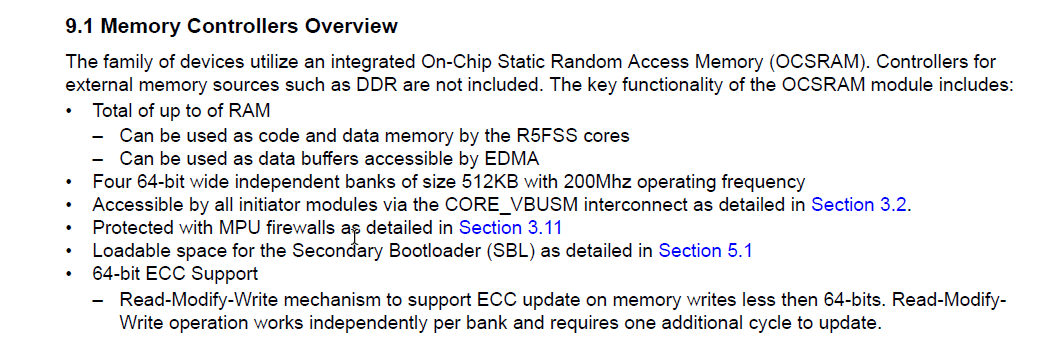

I am evaluating both AM2612 and AM2434. With the same code used for benchmarking, and placing the code, data and stack in the main memory (OCSRAM or MSRAM), with cache enabled, MPU correctly configured, and the clocks as provided in the example demos (R5f @500MHz on AM2612 and 800MHZ on AM2434 on TMDS243EVM board), I am experiencing similar results on both targets, while I expected a better performance with AM2434 which has a higher clock speed for R5F core.
I am trying to find the differences between the two setups: I have the same code, same compiler, same compiler options (-O2), same MPU configuration, different R5 clocks, and the only factor I could think is the MSRAM/OCSRAM clock frequency.
I found in the AM2612 reference manual that the OCSRAM is clocked at 200MHz (see below), but I can not find any information about the MSRAM in AM2434 (as refered in this post: https://e2e.ti.com/support/microcontrollers/arm-based-microcontrollers-group/arm-based-microcontrollers/f/arm-based-microcontrollers-forum/1326676/mcu-plus-sdk-am243x-sram-clock?tisearch=e2e-sitesearch&keymatch=am2434%2525252520sram%2525252520clock):
I am just trying to figure out what leads to this difference, so if you could at least give me the MSRAM frequency in AM2434, that would be great. In my project, the AM24x_GP_EVM.gel script is used to initialize the CPU clocks for the board (with DDR).

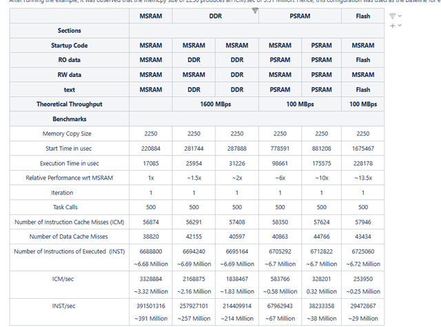

    Memory Latencies :
    The 63.75 ns latency figure is measured specifically for AM64x/AM243x MSRAM from our application note SPRACV1B. We do not have equivalent published latency measurements for AM261x OCSRAM in the benchmark document.
    https://www.ti.com/lit/an/spracv1b/spracv1b.pdf?ts=1773221759391&ref_url=https%253A%252F%252Fwww.google.com%252F
    AM243x: 51 cycles memory latency (63.75 ns at 800 MHz)
    AM261x: 24 cycles memory latency (48 ns at 500 MHz) This data taken from internal Team.
    This shows AM261x has lower memory latency in both cycles and absolute time.
    DHRYSTONE ANALYSIS :
    Your measurements show:
    - AM243x: 1.96 MIPS/MHz at 800 MHz
    https://software-dl.ti.com/mcu-plus-sdk/esd/AM243X/11_02_00_24/exports/docs/api_guide_am243x/EXAMPLES_DHRYSTONE.html
    - AM261x: 1.94 MIPS/MHz at 500 MHz
    https://software-dl.ti.com/mcu-plus-sdk/esd/AM261X/latest/exports/docs/api_guide_am261x/EXAMPLES_DHRYSTONE.html
    The normalized performance (DMIPS/MHz) is nearly identical at approximately 1.95 MIPS/MHz.
    In absolute terms:
    - AM243x: 1.96 × 800 = 1568 DMIPS
    - AM261x: 1.94 × 500 = 970 DMIPS
    AM243x completes Dhrystone 1.6x faster in absolute time, matching the clock ratio (800/500 = 1.6x).
    Dhrystone is specifically designed to fit entirely within L1 cache. The R5F has 32 KB I-Cache and 32 KB D-Cache. Dhrystone code plus data is small enough (only a few KB) to run entirely from cache after the first iteration. It effectively measures CPU plus cache performance only, not memory subsystem performance.
    Your application with 1 MB code size is the critical difference. 1 MB code cannot fit in the 32 KB I-cache. Frequent cache misses force instruction fetches from MSRAM/OCSRAM.
    The memory penalty comparison:
    - AM243x: 51 cycles wasted per cache miss
    - AM261x: 24 cycles wasted per cache miss
    AM243x wastes more than twice the cycles per memory access (51/24 = 2.125x). This additional memory penalty nearly cancels out the 1.6x CPU clock advantage, resulting in similar overall execution time for memory-bound applications.

    Please provide the additional information requested above, and we will continue to investigate this issue.
    Anil.
  • Hello Anil,
    1. What performance value are you expecting? Is the same execution time expected on both AM261x and AM243x?
    According to the architectures of both chips, I would have expected a better performance on AM2434 when code is placed in internal RAM. Currently, it is globally slower on AM2434 (1133ms compared to 945ms on AM261). Also, note this reference application running on TMS570 average execution time is 1788ms (R5 at 300MHz, equivalent compiler options, caches enabled). Reaching only 1133ms (1.6x factor) while core frequency went from 300MHz on TMS570 to 800MHz on AM2434 (2.6x) makes me doubt the measurement on AM2434. As I explained in the previous post, if you consider the absolute time difference for MRAM/OCSRAM latency between AM261 and AM2434, the ratio of performance loss on AM2434 would be 1.3x, but core frequency improves by 1.6x so AM2434 execution time should be slightly lower (= better) on AM2434. At least, I was expecting this.

    We performed benchmarking of the application on different memories with .text, .data, and .rodata sections placed in different memory locations on AM243x devices.
    We found that code executing from OSPI PSRAM demonstrates better performance compared to Flash.
    If you need these benchmark details for AM261x devices, please raise an e2e ticket.
    The appropriate engineer can provide the AM261x device-specific details.

  • Hi Gael,
    These are the example codes which were used for benchmarking PSRAM:
    ocmc_benchmarking.zip
    xip_benchmark.zip
    Please note, these benchmarks were tested on the PSRAM part: APS6408L
    For booting, the modified SBL SD example which initializes APS6408L  was used:
    sbl_sd.zip
    Aryamaan Chaurasia
  • Thanks.
    With this code, I could only reproduce the columns "PSRAM" from the table AM2434 above?
    Gael
  • Hi Gael,
    The modified SBL SD was used only for the PSRAM.
    The OCMC benchmarking and XIP benchmarking can be used with the default SBL OSPI to benchmark MSRAM/On-Chip RAM, DDR, Flash.
    Please make sure the linker.cmd for both these examples are correctly configured for MSRAM, DDR, and Flash.
    Aryamaan Chaurasia
