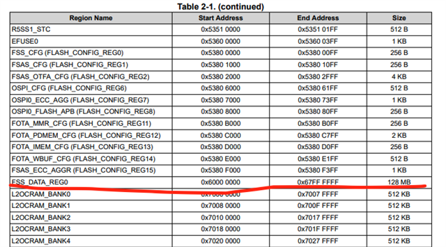

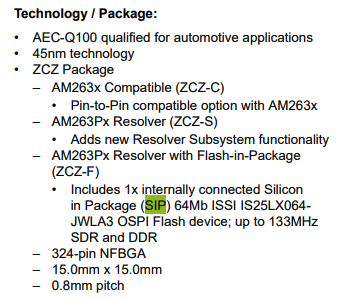

Hi Team,
Reg: AM263P4 SIP variant contains 8 MB of flash memory.
Can you please provide the memory start and end addresses for the flash memory, and how much of the 8 MB memory is accessible?
Rami Reddy.
