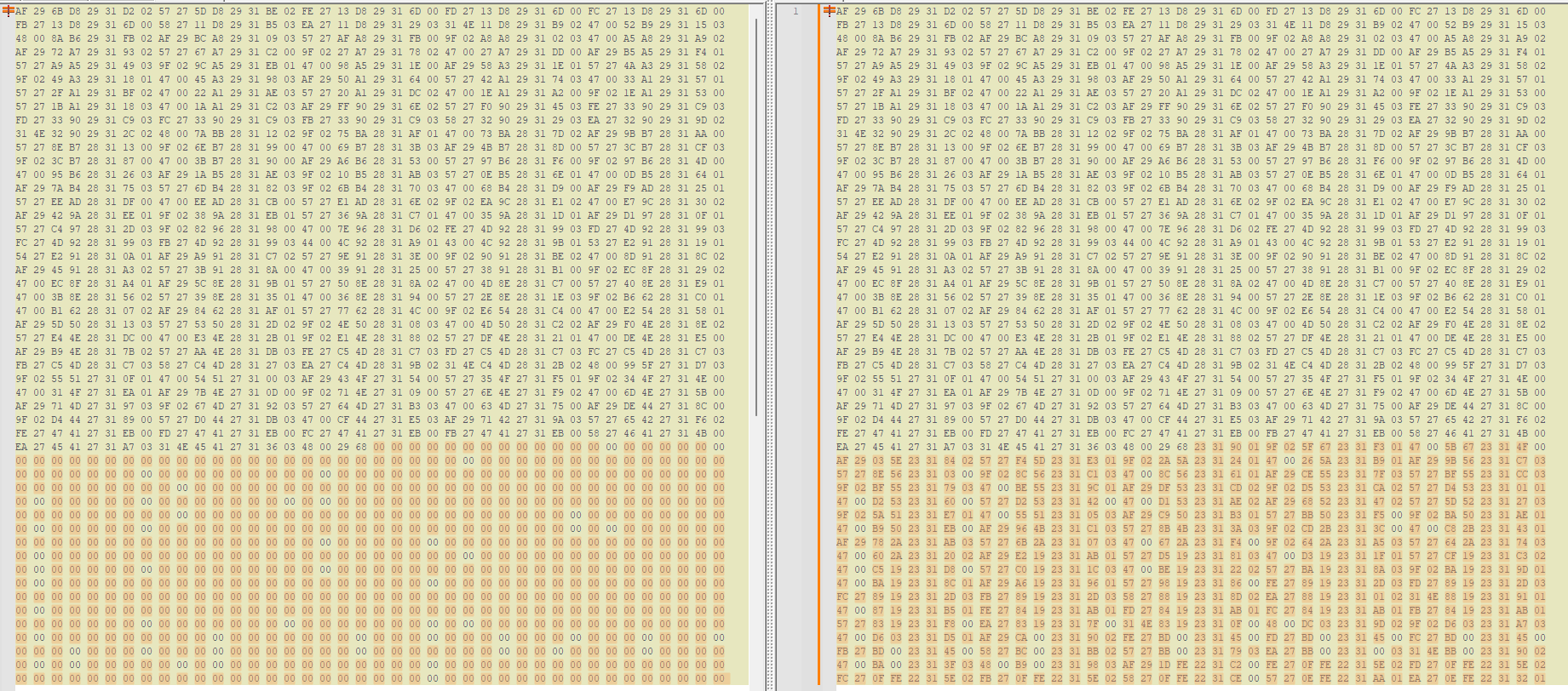

In my code, I see that I am correctly filling the response buffer to the end, but then the response I get is always truncated at 1300 bytes, with the rest filled with zeros. I attach this image as example, on the left the reply and on the right the buffer before is sent.

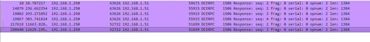

Even in Wireshark, it seems that the len is always 1384.

  • Hi Andrea,
    Thanks for your inquiry.
    the reason for this is the standard size limit of Ethernet frames. If you consider ETH, IP, UDP and DCE/RPC data, you are left with 1384 bytes divided into 84 bytes for the read-response header and 1300 bytes for record data. Nevertheless, the stack supports fragmentation of large records which should be visible in your Wireshark traces (please remove Wireshark filters to see them).

  • Hello Kamil,
    thank you for your reply.
    I removed the wireshark filter but I don't find any other useful packet.
    I have attached the complete Wireshark trace. Could you tell me what other packet I should expect?

  • Hi Andrea,
    with fragmentation you should basically expect the response to be sent over 2 consecutive messages. The first one contains the first 1384 bytes of data and the second one contains the remaining bytes. I don't see this in your Wireshark trace, but I'm wondering:
    1. Why are you sending the read request twice?
    2. Would you please explain your topology?
    3. Where is the TAP located?
    4. If you're using TIA portal, would you please share the project?
    Thanks.
