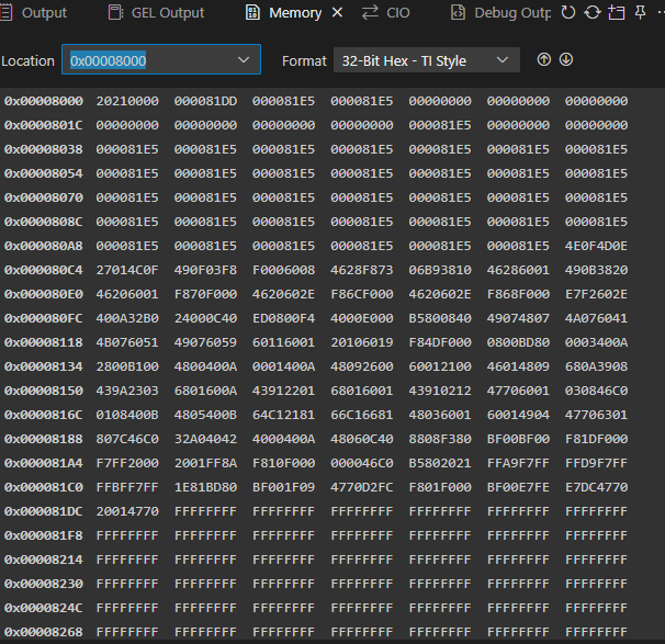

    •  is_application_valid(): Which code will cause you enter into default_hanlder? Please check if CPU can jump to this code line. And read the stack value to check if it is = 0x20210000
    • Please define the hard_fault and NMI handler in your bootloader code to check which specifically cause MCU enter into default_handler.
    • The main() function you shared is application project or bootloader project?
    Zoey
  • Hi Zoey,
    I am coming to is_application_valid(), I am getting stack = 0x20210000. So, as per me If condition should true and it should return result =1, but I am not entering into the loop, by keeping break point i checked, after If condition, when I stepped into it is entering into some while loop in default_handler.
    The main() function I shared is of bootloader.
  • It is so odd. Does every time you call this function, it will enter into default handler?
  • Yes, can You suggest any other better way? Because I am not able to solve this problem. I am expecting to help me out

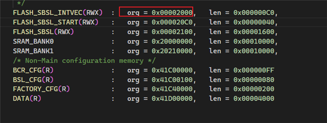

    Secondary BSL is not staring from 0x0000. So you can try to read the address, and see if 0x2000 have the related code.
    And why failed to load again:
    In this demo code, the static flash protected is enabled. In that case, normal flash (mass erase) cannot work and change the related flash. You should do factory reset 7674.Factory reset_Auto.pdf
    I tried to do like this, but I am getting error in debugging. Please check the attached files.
    Error: (Error -1001 @ 0x0) Requested operation is not supported on this device. (Emulation package 20.4.0.3835)
    Trouble Halting Target CPU: Device Connection Error. This could be caused by the device having gone to low power mode. Try forcing an external reset pressing the 'Force Reset' button. If the error persists, try: 1) Invoking BSL, 2) Calling a DSSM Mass erase, or, 3) Calling a DSSM Factory Reset. Check device FAQs for more information.
    Breakpoint Manager: Remove job failed: Register/memory write failure[22005]

  • I tried to do like this, but I am getting error in debugging.
    Could you help to clarify what do you do and where you get such error?
    I want to upgrade the firmware. I am able to do it using ROM BSL. But in ROM BSL 1 problem is that, if there is power OFF during firmware upgrade, at power ON the board become dead, that's why my requirement is, board should not dead, even if there is problem in firmware upgrade, atleast the board should run the previous firmware.

  • Hi, I solved this. Now I am able to read from 0x00058000 and write into 0x0008000. after that I am doing system reset and expecting it to run the new firmware. but its not working. what else need to do
    please help
  • after copying the data from 0x00058000 to 0x00008000, reset is not working, as well as I am doing jump_to_application.

    I solved the problem. I did yesterday mistake only. writing into 0x00008000 using
    DL_FlashCTL_programMemoryFromRAM64WithECCGenerated solved the problem. Now my sp = 0x20210000 and reset value = 0x000081DD
    but when I am entering into
    ((void (*)(void))reset)(); this line I am not understanding what is happening, I am expecting the board should reset and it should run the new firmware. But That's not happening.
    What to do next? How to run the new firmware available at 0x00008000.
