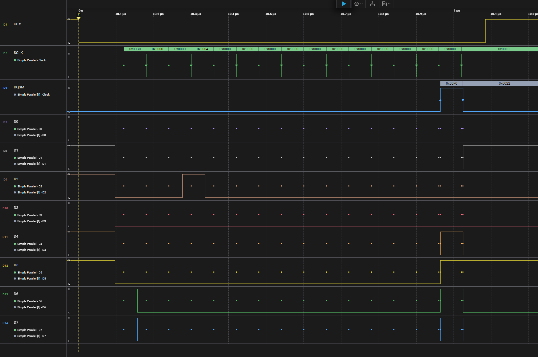

I'm currently trying to integrate a IS66WV032 PSRAM with the OSP1 peripheral on a custom hardware witha TI AM2612 chip.

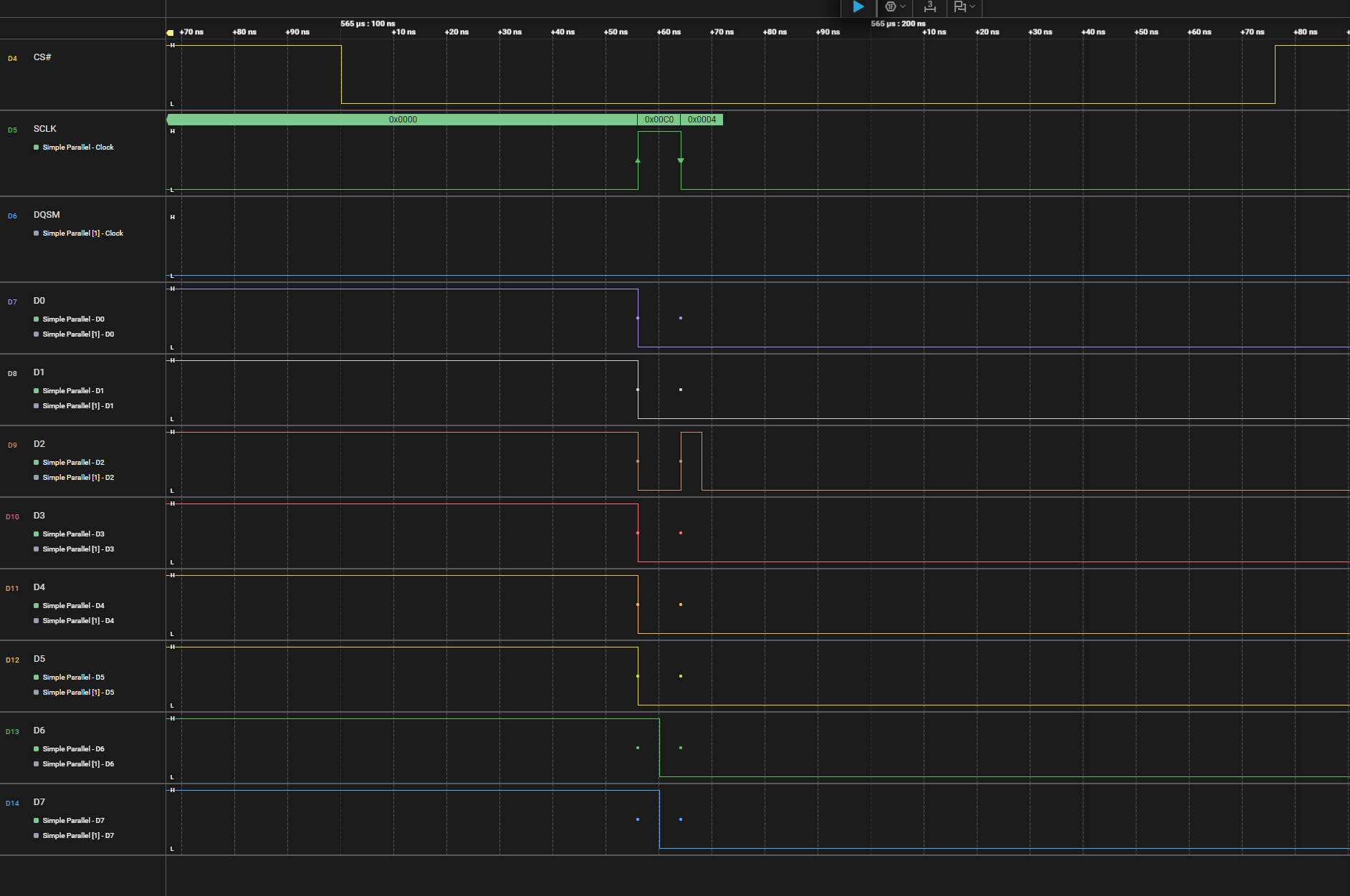

The main issue is the Phy Mode and DQS Signal to correctly sample the input data. As long as the PHY mode is not enabled I'll get the necessary CLK cycles for address, and dummy until the data is sampled. As far as I understood, will the OSP1 peripheral sample the data at the SCLK cycles if the PHY mode is disabled. Only with the PHY mode enabled, the DQS signal is used to sample the data.
If I enable the PHY mode I'll only get one SCLK cycle which is of course not enough to trigger address, and the necessary dummy cycles until the DQS signal is given.
What am I missing to correctly configure the PHY Mode?

    I'm still puzzled what I have to configure in the PHY_MASTER_CONTROL_REG:
    What's the initiator delay?
    What's the intial delay value for the DLL?
    What's the number of increment/decrement indications?
    Furthermore, it seems that the DDR_READ_DELAY_FLD does nothing in the PHY Mode with DQS and DDR enabled. How is it idfferent to the DELAY_FLD in the RD_DATA_CAPTURE_REG?
    Can I influence how many bytes are read in direct access either with PHY_PIPELINE mode enabled or not.
    I'm trying all possible RX_DLL_DELAY_FLD and DELAY_FLD combinations with known data from the PSRAM with PHY Mode active, but I don't seem to get reliable reads above 25mhz. Are the more important tuning parameters which I am missing?

    Unfortunately, the visible DLL lock flags (DLL_OBSERVABLE_LOWER_REG) are fairly coarse. There aren’t readily accessible, more detailed debug registers currently exposed. However, you can indirectly monitor the DLL's behavior:
    • Data Eye Analysis: Use an oscilloscope to examine the data eye opening at the DQ pins. A tight, clear eye indicates good DLL lock. A closed or distorted eye suggests the DLL isn't converging properly.
    • DLL Reset/Resync Cycle: Experiment with the PHY_CONFIG_RESET_FLD and PHY_CONFIG_RESYNC_FLD registers. Repeatedly resetting and resyncing the DLL might help it find a stable lock point, especially if it's getting stuck due to a slight initial imbalance.
