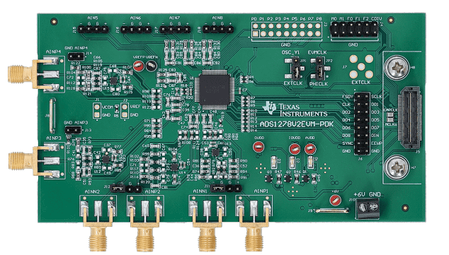

I have been looking to interface the ADS1278EVM-PDK from an arm microcontroller using a SPI interface, via the external controller options outlined in the datasheet. I am having some difficulty transferring data (the clock/ drdy pins seem to be functioning, but there seems to be issues reading the data. I have noticed several of the chips available have example drivers/ device tree overlays, are any of these available for this chip/device?

    In the meantime, I have attached the timing of a SPI frame. The SPI clock is set to 1 MHz on the controller side. We are using the device on low-speed mode, SPI discrete format, with the CLKDIV pins open. We are using the V2 EVM.

  • Hello Joseph,
    It appears you are using a Saleae logic analyzer.  Please send the *.sal logic capture file.  This will be easier to look at timing than the screenshot.  Also, your SCLK duty cycle seems to vary quite a bit.  If possible, increase the sample rate on your logic analyzer.  Disabling all non-used channels can help with this.
    Also, I'm not sure how you have made the connections to your board.  Please refer to below on an example setup and make sure you have configured all signals properly.
    Directions to connect ADS1278EVM to external MCU
    In order to use the ADS1278EVM board with an external controller, you need to remove the PHI board, otherwise, the digital lines will be driven by the PHI board preventing correct operation with an external MCU.
    1.  Provide +6V on J10 from an external bench supply.
    2.  Move jumper JP1 to the 27MHz position, this enables the on-board 27MHz oscillator.
    3.  Move jumper JP2 to the EVMCLK position, this selects the on-board 27MHz oscillator.
    4.  You may need to install jumpers on J4, depending on the mode of operation that you want to use.  For example, configure ADC for high-speed, SPI, TDM, Dynamic, then you will need to install jumpers on MODE0, MODE1, FORMAT0, FORMAT1, and FORMAT2.  CLKDIV should remain open (high).
    For the SPI connections on J6:
    1.  MISO -> DOUT1
    2.  SCLK -> SCLK
    3.  Connect DIN to GND, do not leave floating.
    4.  Connect /SYNC to an IO pin on your MCU (needed for robust power-up reset), or tie to IOVDD for test purposes.
    5.  Connect /DRDY to an IO pin your MCU.  This is an output from the ADC, indicating when data are ready to be read.  The code should monitor this pin (polling or interrupt) and only transfer data after a falling edge (Figure 77).
    Keith
  • Hi Keith,
     The MCU I'm currently using is a rasbperry pi 4. I have tied DRDY to a gpio, SCLK to SCLK, DOUT1 to MISO, and SYNC to 3.3V. I've also tied DIN to GND. The device is set in low-speed mode, SPI Discrete format, with fMOD = fCLK/40.
    The logic analyzer is being sampled at 100 MS/s. It says I can't attach the .SAL files here? Is there a possible other solution for this?

  • Hello Joseph,
    Using discrete mode will use all 8 DOUT lines, 1 for each of the ADC channels.  Unless you have 8 SPI ports on your processor, I do not think this mode will work for you.  I suggest using TDM mode (fixed or dynamic) which will interleave all 8 channels over the DOUT1 pin.  However, for debug purposes, you can keep it in discrete mode and just focus on correctly reading data from a single ADC channel.
    I have been able to attach *.sal files in the past, but it is possible this has been disabled.  I do not think drag and drop will work; use the Insert->Image/Video/File option if you did not already do this.  It may be worth trying a second time just in case.  Also, you could change the extension to *.txt; that may allow the file to be attached and then I can change it back to *.sal to view with the Logic software.
    If all else fails, try attaching another image.  In this case, capture the falling edge of /DRDY in the image, and then show the 24 SCLKs as well as the DOUT1 line.  You must read the data before the next conversion result is ready.  With 27MHz clock and fmod=fclk/40, your data rate will be 10.5ksps.  You will need to read the 24b result in less than the 94us conversion rate period.  If you wait too long after the /DRDY falling edge before clocking the data out, then you will get corrupted data.
    Also, this could be an input configuration issue.  What input voltage are you trying to measure in this test case?  If you could provide an a sketch on how you have the inputs connected that may be helpful.

    Hi Keith,
    Thanks for the help, I really appreciate it. Had some issue uploading docs for a little bit but seems that I can upload the text files/ diagram now. I have three different inputs: one where there are no connections to the input, and the other two where a 1kHz sine wave is applied in a single-ended (directly from function generator to AINP1 and GND) and a differential (from a differential amplifier to AINN1/AINP1).
    Based on what you've indicated it seems I'm having some clock-related issues that are probably more on the mcu side. I've been trying to fix issues here; is there anything I need to do to better drive the input side?

  • Hi Joseph,
    I assume you are using a clock frequency of 27MHz for the ADS1278?  If so, the maximum frequency for SCLK must be 27MHz or lower.  I was able to read the attached files with the Logic software, and it appears your SCLK frequency is not stable, and exceeds 27MHz in several clock periods.
    I would focus on getting a clean SCLK with a nice steady frequency.  In fact, since you are running at such a slow speed for your data rate, you can slow SLCK down quite a bit.  I suggest setting SCLK to fCLK/4, or 6.75MHz assuming fCLK is 27MHz.  This will help with any timing related issues.
    Also, you should read the data as soon as possible after the falling edge of /DRDY.  In the attached captures, you are waiting until the next conversion result is ready, and if you do not read the results in time, the data will be corrupted.
    Keith
  • Hi Keith,
    Thanks for all your help! This worked, and data is being collected properly now. Found some instabilities when I lowered the clock rate too much, settled at fCLK/2 (13 kHz). This and some modifications to the interrupt handling on the RPi end fixed my issue.
