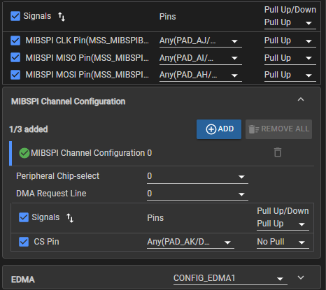

I have implemented a MSS_MIBSPIB Controller freertos project on a R5-0 processor on a AM2732 device.
My code runs correctly without any error. The main code is shown below:

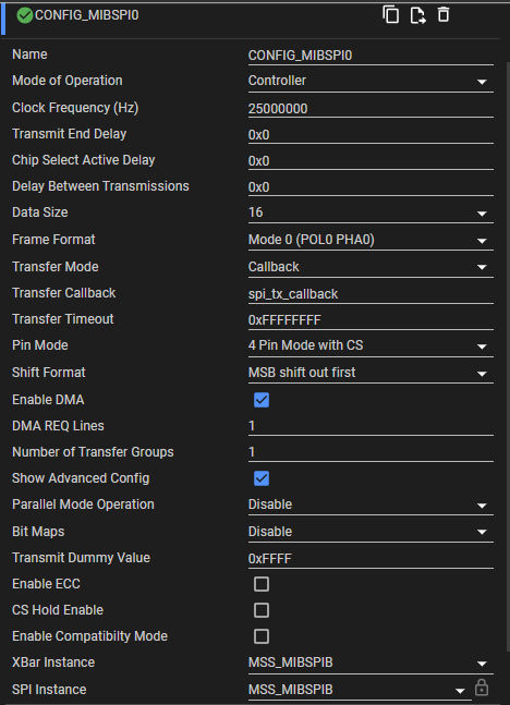

The syscfg is shown below:
When I try to transfer the exact same code and syscfg options to a freertos system project to the exact same R5-0 processor, the project does not run correctly. To be exact the MIBSPI_transfer function fails.
After a lot of debugging inside the MIBSPI_transfer function I see that in the freertos system project it seems that the icount option is NOT enabled and in the freertos R5-0 project is ENABLED. But that makes no sense since there is no icount option when SPI is configured as a Controller and moreover I put by hand the exact same configurations in syscfg in the 2 projects. This difference with icount option has as a result to run different parts of the driver code and end up to failure.
Why is that happening?

    The syscfg tool for AM273x only provides the "Enable Multi ICount Support" option for the block mode (not for the callback mode). Again it has nothing to do the system project. It is only related to the syscfg file associate with the CCS project for the specific core (R5F cores or the DSP core).
    Ming
  • Hi Ming,
    I think you are missing the point here. Let me elaborate this further to you so that we are aligned.
    Inside CCS 20.4.0, we import the R5_0 empty FreeRTOS project. Inside the example.syscfg file of that standalone project we add one instance of the MIBSPI and configure it with some parameters in callback mode as Dimitra showed in the screenshots above. There is no option for iCount inside the graphical interface. However in the background if we open the .syscfg file with the built in Text Editor inside CCS we see iCountSupport = TRUE.
    Everything works the way we want it when we are in standalone project.
    Now we remove that R5_0 STANDALONE project and we import the SYSTEM FreeRTOS project inside CCS 20.4.0. Once again we open the example.syscfg of the R5_0 of the SYSTEM FreeRTOS project and we configure the EXACT SAME SETTINGS as in the STANDALONE project.
    The driver now doesn't work as expected. If we now edit the example.syscfg file with the built-in Text Editor of CCS we do no longer see this line saying iCountSupport = TRUE. And that is very strange.
    To sum up and leave no room for misunderstanding, when a standalone project is loaded and MIBSPI is added and configured in callback mode, the iCountSupport is generated and set to TRUE inside the .syscfg file, while that does not happen if we repeat the exact same process for the exact same processor and MIBSPI settings inside a system project.
