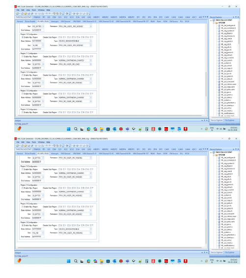

We are currently using both EMIF and SPI3 in the same project.The MPU settings were initially configured for EMIF, and EMIF is working as expected. However, when using SPI3 with the same MPU configuration, we are facing the following issues:SPI3 is unable to generate the clock.The Chip Select (CS) pin is not being controlled properly.If we modify the MPU settings specifically for SPI3, then SPI3 starts working correctly, but this impacts the EMIF configuration.Could you please clarify how the MPU regions should be configured when both EMIF and SPI3 need to be used simultaneously? Is separate MPU region configuration required for each peripheral?

  • Ok Jagdish, here I have attached the clear image

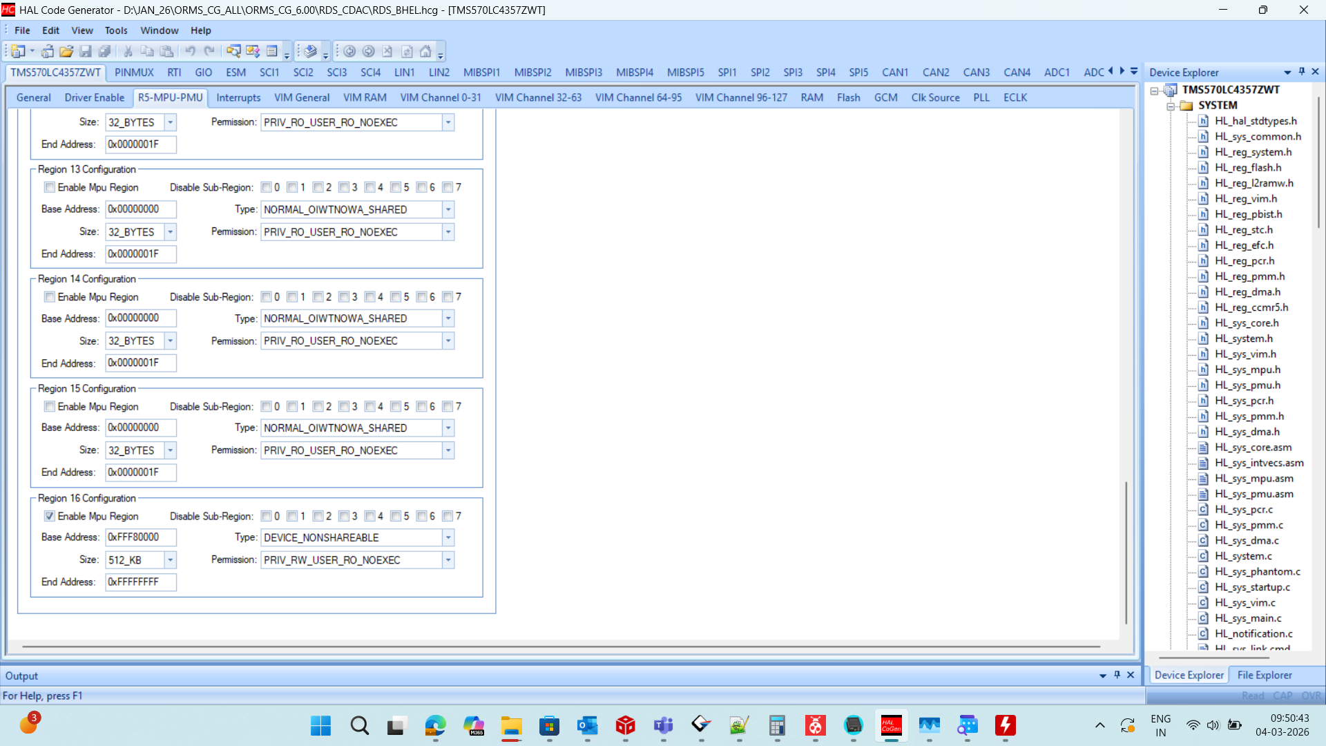

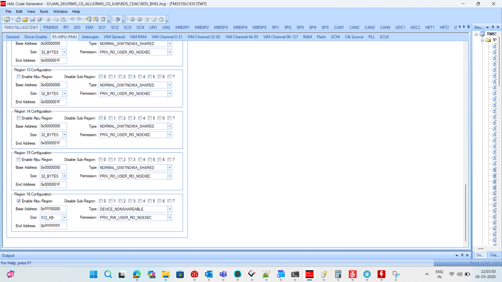

    Exactly what MPU settings you are ching to make it work SPI3. Could you please elaborate these details?

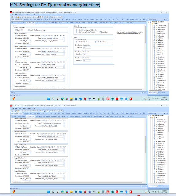

  • We have configured the MPU settings as shown below to enable proper operation of the EMIF peripheral. However, with these settings applied, the SPI3 and I2C1 modules are not functioning. If we modify any of these MPU settings, the Ethernet and EMIF modules stop working.
    Could you please advise on how to resolve this issue so that SPI3, I2C1, Ethernet, and EMIF modules can operate correctly together?
  • Hi Prasanna,
    Is it possible to share your complete project, so that i can quickly debug it at my end?
    And also, which board you are using, is it TI-specific board or custom board?
    I never came across this kind of issue before, usually EMIF, i2c and SPI will operate independently only.
    If you are not using TI-specific board then provide project where EMIF should work and SPI3 should not work. Because i can easily verify SPI3 behavior and can identify what went wrong.
