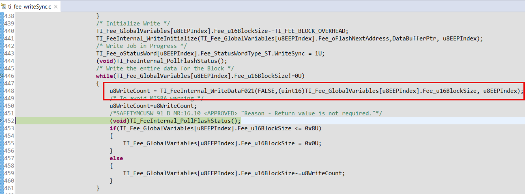

Our application init code is indeed detecting the corrupted data, but trying to write back correct values here I have some stranges behaviors. We correctly initilialized the FEE with TI_Fee_Init(), before all of this.
It seems that the data inside the FEE cannot be (or partially) physically written properly, even if the code shows that we go to a wrting sequence and use FlashAPI F021 Write function.
Nevertheless, after some restarts, corruption still being detected, the data are finally properly written.

    1) At 0xF0200450 address, according to the block header 0xFFFFFFFF 0x00000000 0xF0200060 0xFFFFFFFF 0xFFFFFFFF 0xFFFFFFFF, it seems to be a failed new attempt to write block 1 ( I see previous valid address 0xF0200060, match where was the block 1 with one voluntary corrupted value). We see afterwards some data which has been partially written,

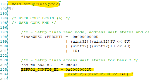

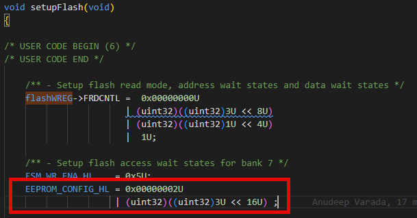

    Please double check if the wait states for EEPROM has been set correctly. Per datasheet, the wait states at 160MHz system clock should be 3.
    It is configured by writing 0x3 to EWAIT filed of EEPROM_CONFIG register: 0xFFF8_72B8.
    The code is in system.c:
  • Hi QJ,
    Thank you for the feedback.
    I confirm to you that we have the indicated wait states for EEPROM in our project :
