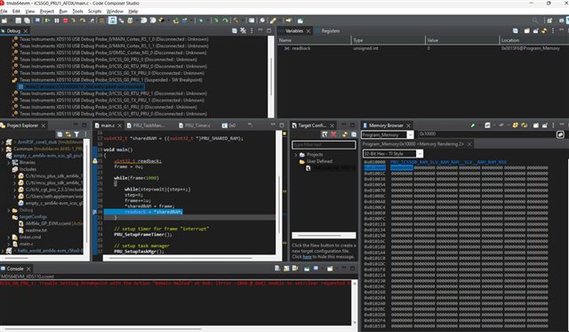

  • I am loading the referenced project as a starting point at your link, and slightly modifying the code to write to some registers (Task Manager and IEP config registers) and write to and read from Shared RAM (0x1_0000). When I write to these addresses, I do not see the values update in the memory viewer. When I try to read back any of these written values, I just get 0s. Is there something I need to do to enable access to reading or writing memory? Perhaps a missing step in the load/debug process not discussed in the Acadmy?
  • Additional details. I am trying to use the Memory Browser "fill memory" option to write a series of bytes to PRU shared RAM:
    But I get an error when trying to do so:
    This is even when I am connected and able to step through the code i have loaded.. So is there some setting in code I need to set in order to write to any of these addresses?
  • Last bit of data... I changed the code to be an array access rather than a pointer access, but tried placing the array in the shared RAM address via the DATA_SECTION pragma:
    and defining the section in the linker file:
    However when I link after compiling, I get a warning the results in failing to generate somethign I can load:

    warning #10015-D: output file "ICSSG0_PRU1_AFDX.out" cannot be loaded and run on a target system
    How to resolve?
    Looks like the linker creating a symbols with PRU instructions LDI 16-bit immediate values (max 0xFFFF).
    This should work instead. Also PRU supports LDI32 for direct constants. I will also let to  to comment further.
    volatile int *shared_mem_array = (volatile int*)0x10000;
    shared_mem_array[frame] = frame + 100;
    BR

  • Thanks I posted a bit of a cascade on Friday as I ran into several walls during my lab shift. At this point let's just say that my remaining open questions are:
    1) Are there any project/linker/etc settings I need before writing to PRU registers from PRU C code
    2) Can you point me to any explainers/docs that discuss what the PAGE 0 and PAGE 1 etc keywords are in the linker, and how they relate to the memory map in the TRM
    Per your inquiry, yes I used empty_c as my project starting point, and am developing in C (with a few mixed assembly lines for using the XIN instruction). I will take a look at your PR and see if anything sticks out. So I know what I am trying to avoid, at a high level, what sorts of settings did you notice would be potentially problematic for a C project?
  • Thanks that update work. I also managed last week to resolve the issue by defining the section in memory:
    SECTIONS
       .shared_mem > PRU_SHAREDMEM, PAGE 2
    And adding keyword "__far" when declaring and definig the array in the C file:
    #pragma DATA_SECTION(shared_mem_array, ".shared_mem")
    __far int shared_mem_array[100];
    DO you have a preference of one method over the other or are they both going to do the same thing under the hood?
