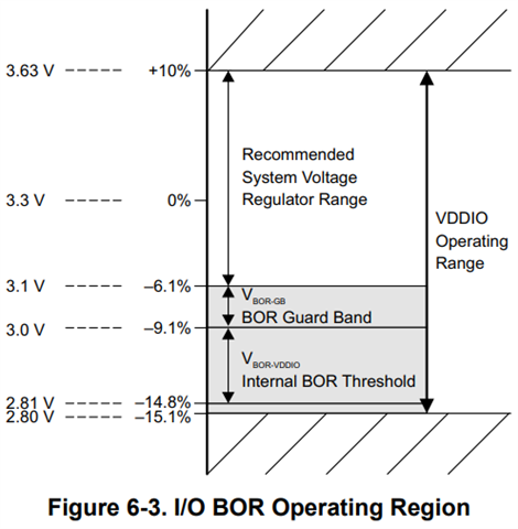

  1. What is the required ripple for each power rail? I couldn’t find this specification in the datasheet.
    Voltage ripple is typically not a concern as long as the voltage remains within the recommended operating voltage. See below diagram for reference values. Proper decoupling of voltage rails should be sufficient, please refer to datasheet recommendations accordingly for each voltage rail

  • Hi Jenney,
    What is the method of power-down the device? I see there is also some oscillation of the power rail further in the graph. Typically the internal power management module will be responsible for ensuring proper power-on and power-off of the device to protect from long-term damage
    Peter
  • Hi Peter,
    You mean 'power-on and power-off of the device abnormally will cause the long-term damage',right? The internal power management module needs the software development, right? Where i can get the docments about this?
    Jenney
  • Hi Jenney,
    The PMM is internal module, but it doesn't need any software intervention. It acts automatically to detect any improper power supplied to device and puts MCU in reset if applicable. This and decoupling caps is why we do not specify the voltage ripple requirements for power. You can see more information on this in the PMM section of the datasheet, but there is no registers associated with this PMM module
