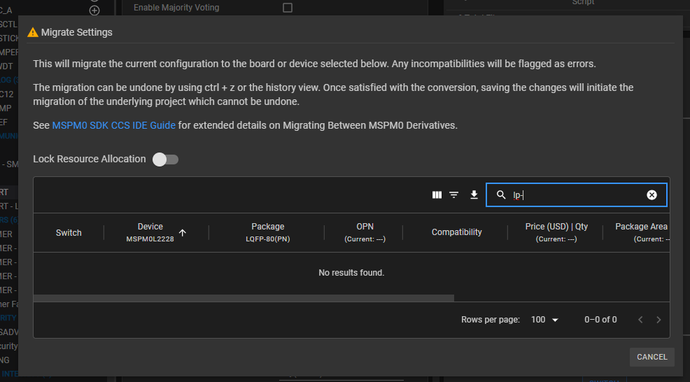

I guess in the latest version of sysconfig the switch device interface changed so now you can compare devices, but I noticed that you can't use this anymore to switch to the board view of a specific launchpad:
Is there a way to get a LP board view and pinout back in sysconfig?

  • Hi Munan,
    After speaking with our software team, it seems like you and I were on version 1.26 or older.
    I just updated to 1.27 and this is what I see now:
    If you click on Migrate To A Specific Device you will see:
    The other option (Help Me Choose My Device) will show the view that you had shared.
