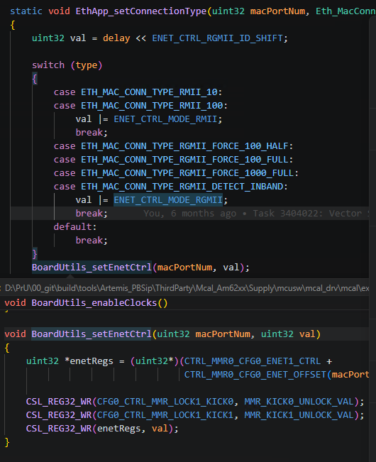

    According to the MCAL user guide only the dma, clock and pinmux are the things to be taken care by the application to enable the Eth, Ethtrcv modules
    But from the example this code is necessary for tx or rx
    Could you please explain the significance of this code, and it has to manually added before the Initialization of Eth??
    Or this can be taken care by any configuration??
    Please provide the info on the same
    Thanks, and Regards
    Priyadarshini U
  • Hi Priyadarshini,
    We were unable to run the host application in the wsl
    We will internally check if this is causing any issues to run the application from our end. But the test cases would expect specific patterns of traffic. In case the application is not responding correctly, we cannot support testing with custom script while the application is already available.
    Can you please point to the documentation you are reffering to? The application would need these configurations, but there would be more modules which needs to be configured from the application side like the PHY-to-MAC interface, etc. The application would be setup to handle both Tx and Rx packets.
    The mentioned code snippet configures the MII layer between MAC and PHY to exchange information between the Eth Tranceiver and the CPSW module.
    Are you asking where and how to configure this in your application? In the examples provided by TI MCAL package, these configuration settings are already handled for the TI EVMs and no additional configuration is required.
    Thanks and regards,
    Teja.
    We have currently initialized this before the Eth_Init and Trcv Init
    please let us know this is sufficient
    Note: We are using the autosar stack for our application
    Please let us know this information
    Priyadarshini U

    The host and target app are tied closely, it basically works on cmd response model. So, it's better to test them together. If you want to test the target app with some python script or windows based host application, then you should exaclty mimic the functionality of host app provided in the MCAL package.
    You can ignore the function BoardUtils_setEnetCtrl, these funcitons are basically from our RTOS based driver and used in the example apps to do the system level initialization, Since the Eth example app is not using the Mcu module for ECU level initialization.
    For your use case, you can still integarate the Eth and EthTrcv module without considering the BoardUtils_setEnetCtrl function.
    Thank You.
