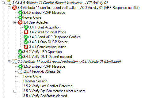

  • Hi Pourya,
    Setting both switches with AutoNeg ON step 2 is passed(before failed), but now I have an issue regarding this topic:
    Do you know where could be the problem?
    Best regards.
    Stefano
  • Hi Stefano,
    To narrow down the problem, I suggest first testing with the AM243x-LP board (as mentioned in my previous answer, the test should pass if your setup is correct).
    Once you've successfully run the test on the AM243x-LP board and resolved any setup issues, we can assume that the testing configuration is working properly. At that point, you can proceed to testing your custom hardware. This methodical approach will help us better isolate the source of the problem.
    Pourya

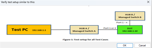

  • Hi Stefano,
    the test setup should be relatively simple, you would just need a switch between your Test PC and your Device, you should let the other port of the device be free and do not connect it to any other network.
    There is specific test step during the test which asks you to connect the second port to another device, but before that make sure it is disconnected.
    Other than that (and the PHY settings (Auto-negotiation, Speed/Duplex settings), I can't think of any other setup failures.
    Pourya
