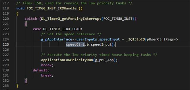

i change speedCtrl to 400.
it can run as below.
waveform is as below.
questions:
I want to run the motor at very low speed and high accuracy. but it can only run when I set >400.
any idea?

    From what I can see, you'll have to change the values in this IRQ to change the speed. I would recommend to break down what the IQ15toIQ functions does in this case, or to simply play around with any value that will fit your application better. For reference, you can search the load value that by default is set in the sysconfig file.

    I found that MIN_TARGET_SPEED  is 1342177.
    below code limit the min speed.
    /*! @brief minimum target duty in float */
    #define MIN_TARGET_DUTY_FLOAT                       0.01
    /*! @brief minimum speed */
    #define MIN_TARGET_SPEED                            _IQ(MIN_TARGET_DUTY_FLOAT)
            if((targetSpeed < MIN_TARGET_SPEED) ||
                    (pMC_App->maximumSpeed == 0))
                targetSpeed = 0;
    when I set speedCtrl= 400 => g_pAppInterface->userInputs.speedInput =1638400
    then motor can run.
    If I set below, motor cannot run.
    #define MIN_TARGET_DUTY_FLOAT                       0.001
    any idea how to adjust this value?
