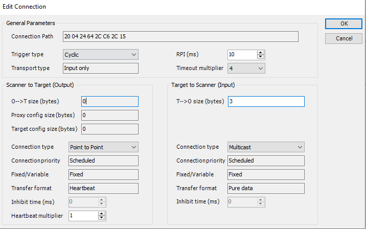

I'm having issue with periodic timeouts when I set my Input only and Listen only connections as multicast. With point to point configuration I have no issue. Is there any specific operation I have to handle in assembly or any other configuration for multicast that is different from point to point? Here are settings from codesys and wireshark logs:
image.pngmulticast.zip
Thank you for help.
