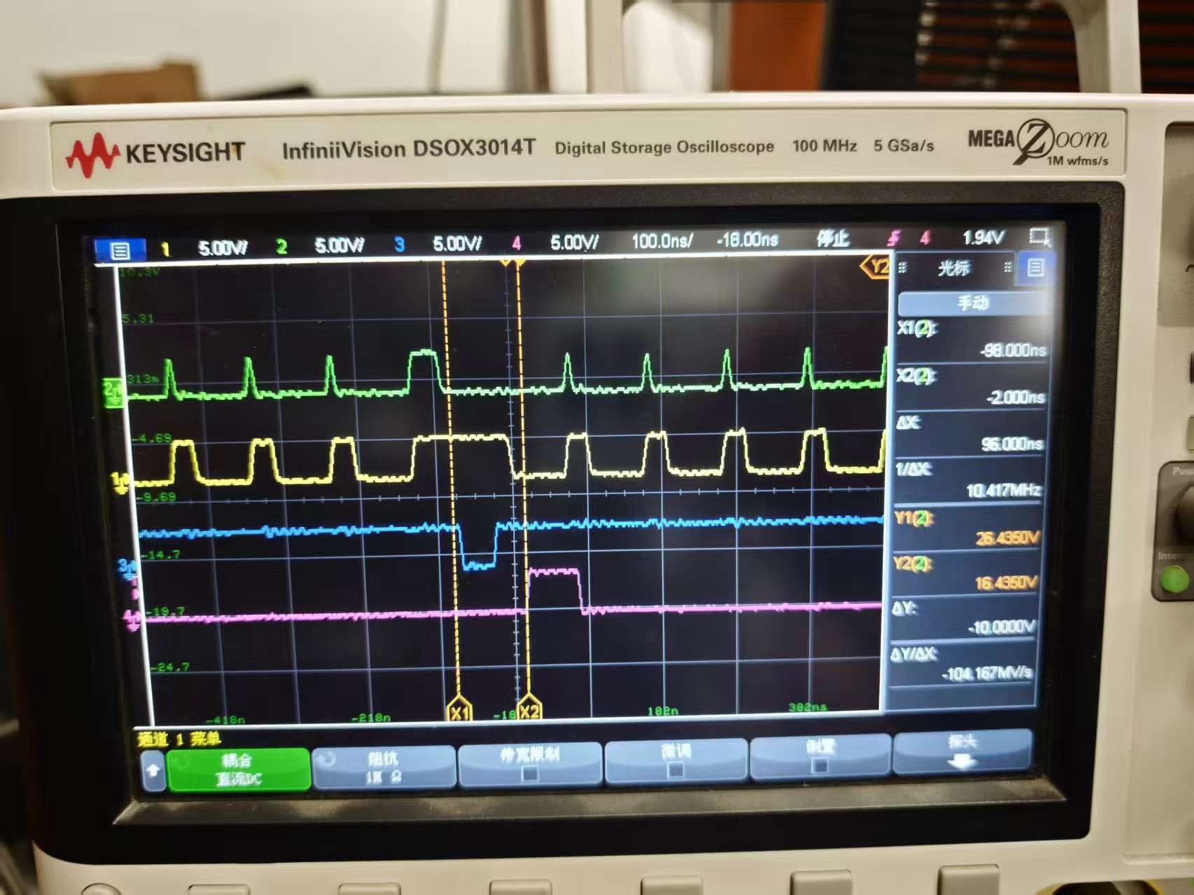

Customer test the GPMC interface, now it connect to FPGA.
During one CS assert, the read and write opration is observed via the waveform.
Please see below screen. Just want to check if this behavior is the expected one that read and write exist in one cs assert?
The waveform from top to bottom is cs, read, write signal.
Zekun

    Do you mean is it okay to have this sequence on GPMC:
    CS assert -> read data from FPGA -> write data to FPGA -> CS de-assert ?
    I can see 4 waveforms on the screen. Which color is which?
    What is the mode of GPMC operation?
    Stan
  • Hi :
    We are using a single-read/write mode, employing a shared approach between DMA and direct read/write. DMA is used for reading and writing large amounts of data, while direct read/write is used for small amounts of data.
    Then we captured this waveform, which cannot be used, causing data errors
    In addition, after we disable the DMA function and use direct read-write mode, this waveform will no longer exist
    Jimmy

    Thanks for the reply. Want to check one thing with you.
    There will be direct R/W and DMA R/W co-existing in your scenario, right? So how do you know when to trigger the DMA read when you are doing a direct R/W?
    If you are doing a direct R or W, let say an interrupt is coming and trigger the DMA R or W, does this scenario happen in your real case?
      Please share your ideas if this is the expected behavior, Thanks.
    Zekun
  • Hi Zekun
    DMA reading and direct reading will definitely coexist due to multi-threaded operations, but I am not sure when DMA will operate GPMC.
    Indeed, DMA read/write operations may be inserted into the direct read/write process, or direct read/write operations may be inserted into the DMA read/write process.
    Jimmy
  • Hi  Jimmy
    So there is no priority difference assigned on multi-thread, like direct R/W in low priority, DMA R/W in high priority, right?
    Can you elaborate this waveform causing the data error?
    Like the direct R/W data is error while the DMA R/W data is correct, or on the other hand DMA is error while direct R/W is correct?
    But the way, what is the frequency of this issue in your circumstance?
    Zekun
  • Hi Zekun
    Yes, there is no difference in priority between direct read/write and DMA read/write. We have two threads with different priorities that operate on GPMC. Both direct read/write and DMA read/write exist in each thread. The criterion for distinguishing between direct read/write and DMA read/write is the amount of data (DMA read/write is used for data larger than 128 bytes)
    This waveform indicates the presence of both read and write operations within a single chip select signal, leading to confusion for our FPGA regarding whether the controller intends to perform a read or write operation.
    In the case of a large amount of data, this waveform appears once every ten or so seconds.
    Jimmy

    So in one high priority thread:
    Logis is
    if (Large amont)
    DMA R/W, else
    Direct R/W
    end
    Another low priority thread:
    if (Large amont)
    DMA R/W, else
    Direct R/W
    end
    Is this right?
    Zekun
  • Hi Zekun
    Yes, that's the logic
    Jimmy
  • Hi Jmmy
    So the logic and the waveform match. I do not think it is abnormal issue.
    What is the your expectation to this observation?
    Zekun
  • Hi Zekun
    I believe that whether it's the CPU operating GPMC or the DMA operating GPMC, even if commands are issued simultaneously, the GPMC controller should not introduce any timing confusion, which could prevent external devices from recognizing the timing sequence.
    Jimmy
