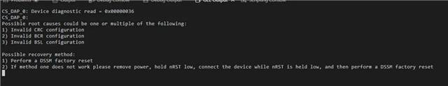

I am experiencing a permanent DAP connection error on my custom board using the MSPM0G3518 and I have been unable to recover it after trying all suggested methods.
Error Message:
CS_DAP_0: Device diagnostic read = 0x00000036
Possible root causes: Invalid CRC configuration, Invalid BCR configuration, Invalid BSL configuration.
DAP Connection Error. This could be caused by the device having gone to low power mode.
Try forcing an external reset.If the error persists, try forcing BSL, a Mass erase or a Factory Reset. Check device FAQs for more information.

  • Hi Elif,
    The device diagnostic read of 0x36 means the device is in the maximum restrictive state due to an invalid NONMAIN configuration or NONMAIN was erased.
    If there is an invalid NONMAIN configuration, or NONMAIN is erased and not flash before power cycling, the device will end up in this state.
    Owen

  • Hi Elif,
    Diagnostic read of 0x00010136 means: Boot failed. Possible reason is that the NONMAIN CRC checksum verification fails.
    Diagnostic read of 0x0004110A means: Boot success. BSL is invoked and executed.
    Diagnostic read of 0x00000036 means: Invalid NONMAIN configuration or NONMAIN was erased. Device is no longer recoverable.
    1. Root cause is that you are erasing NONMAIN without flashing the default configuration or a valid configuration.
    2. You can prevent this from occurring by ensuring that NONMAIN is always valid. Do not erase NONMAIN and power-cycle device before restoring NONMAIN to default state or with a valid configuration.
    3. You can find the default values of the NONMAIN Configuration within the Technical Reference Manual for the device-specific family (i.e., MSPM0 G-Series 80-MHz Microcontrollers Technical Reference Manual). You can then create the file similarly to how the Configuration_NVM_MSPM0G3507_Default_value.txt are formatted (TI-TXT).
    4. There are no paths of recovery if the diagnostic read is 0x00000036.
    You may find the MSPM0 NONMAIN Flash Operation Guide helpful.
