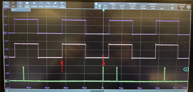

We would like to add 3 features to TI SDK's source/networking/enet/core/examples/tsn/gptp_cpsw_app example for our project:
First, configure CPTS module to generate periodic GENF (CPTS_GENF0) signal (say 40kHz).
As dipicted in Technical Reference Manual, Figure 10-56. SoC Time Sync Architecture:
Second, configure Time Sync Router to output the CPTS_GENF0 to SYNC0_OUT, which can be routed to SYNC1_OUT_TP on AM243x EVM.
Third, connect to an interrupt handler that is triggered at the start of a CPTS_GENF0 period.
I think we know how to do generate the 40kHz CPTS_GENF0 signal. However, how to route CPTS_GENF0 to SYNC0_OUT and how to connect to interrupt handler seems to quite complex and no examples documented.
Can anyone in E2E please help with these?
We are using AM243x EVM and TI MCU plus SDK 11.01.00.17.
Thank you in advance!

    I was able to able to see 40kHz signal on J12 pin 1, with the following changes:
    • Added Pinmux_config(gCustomPinMux, PINMUX_DOMAIN_ID_MAIN) call before enabling GENF.
    • Halved the GENF frequency calculation in ConfigureGenF():
      -  genFLength = CPTS_RFTCLK_FREQ_HZ / (freqHz * 2U);
      +  genFLength = CPTS_RFTCLK_FREQ_HZ / (freqHz);
    Also, using Sciclient_rmIrqSetRaw() and ENET_IOCTL() CPSW_CPTS_IOCTL_REGISTER_HWPUSH_CALLBACK, I was able to see the callback gets called approximate 40,000 calls in one second.
    However, I had trouble routing GENF to multiple outputs (SYNC0_OUT and CPTS_HW1_PUSH) at the same time.

  • Hi Matt,
    I was able to verify that your changes with halving the genF count looks correct since I observed the same thing as well. Looks like, I had the wrong understanding of this calculation where the genF freq is not given per toggle, but rather for a full cycle. The earlier calculation was based on number of ticks needed per toggle. The current config is with number of ticks needed for full period of our target frequency signal. This has been confirmed by our experts yesterday. I was able to reproduce this from my end.
    Coming to the part where we need to route GENF to both SYNC0_OUT and HW push event, I have not tried to configure this yet, but let me check the behavior on that. If this becomes difficult, we can configure a second GENF, which will be in sync with the other GENF to trigger the second signal.
    I will keep you posted on our findings.
    Thanks and regards,
    Teja.
  • Hi Matt,
    I was able to get the interrupt along with the external signal working by using 2 GenF instances. I am attaching the same to enable this in gptp_cpsw_app example. We are looking to verify if we can use a single input GenF to create 2 outputs. We will confirm this by Monday.

    #ifdef TF_USE_GENF
    /* GENF Configuration Parameters */
    #define GENF_OUTPUT_FREQ_HZ         (40000U)     /* 40 KHz output frequency */
    #define CPTS_RFTCLK_FREQ_HZ         (200000000U) /* 200 MHz reference clock for AM64x */
    #define GENF_INDEX_1                (0U)         /* Use GENF0 */
    #define GENF_INDEX_2                (1U)         /* Use GENF1 */
    #define GENF_POLARITY_HIGH          (1U)
    #define GENF_POLARITY_LOW           (0U)
    /* Timesync Router Configuration for AM243x/AM64x
     * The TIMESYNC_EVENT_INTROUTER0 routes CPTS events to output pins/signals.
     * GENF0 (input 21) is routed to SYNC0_OUT pin for external sync output.
     * GENF1 (input 22) is routed to HW_PUSH_EVENT0 (input 30 on router output)
     * so the CPTS captures a timestamp on each GENF1 toggle — readable via
     * the CPSW_CPTS_IOCTL_REGISTER_HWPUSH_CALLBACK callback (getTsval).
    #define TIMESYNC_INTRTR0_BASE       (CSL_TIMESYNC_EVENT_INTROUTER0_CFG_BASE)
    #define TIMESYNC_IN_CPSW0_GENF0     (CSLR_TIMESYNC_EVENT_INTROUTER0_IN_CPSW0_CPTS_GENF0_0)  /* router input 21: CPSW GENF0 */
    #define TIMESYNC_IN_CPSW0_GENF1     (CSLR_TIMESYNC_EVENT_INTROUTER0_IN_CPSW0_CPTS_GENF1_0)  /* router input 22: CPSW GENF1 */
    #define TIMESYNC_OUT_SYNC0_PIN      (24U)        /* router output 24: SYNC0_OUT physical pin */
    #define TIMESYNC_OUT_HW_EVENT0      (30U)        /* router output 30: CPTS HW_PUSH input 0 */
    uint32_t tsindex = 0;
    uint64_t tsVal[20] = {0};
     * @brief HW push event callback — invoked by CPTS driver when a HW_PUSH
     *        input is asserted (GENF1 toggle routed via Timesync Router).
     * Called from interrupt context. Captures the raw 64-bit GTC counter value
     * (not CPTS nanoseconds) into a 20-entry ring buffer for later inspection.
     * GTC_getCount64() is used here because it is safe to call from ISR context;
     * ENET IOCTL calls are not safe from ISR context.
     * @param cbArg      hEnet handle passed at registration (see ConfigureGenF)
     * @param hwPushNum  HW push instance number that fired (CPSW_CPTS_HWPUSH_1)
    void getTsval(void *cbArg, CpswCpts_HwPush hwPushNum)
        tsVal[tsindex % 20] = GTC_getCount64();
        tsindex++;
     * @brief Configure CPTS GENF (Generic Function) output
     * @param hEnet     Enet driver handle
     * @param freqHz    Desired output frequency in Hz
     * @param enable    Enable (true) or disable (false) GENF
     * @return int32_t  ENET_SOK on success
    int32_t ConfigureGenF(Enet_Handle hEnet, uint32_t freqHz, bool enable)
        int32_t status;
        uint32_t coreId = EnetSoc_getCoreId();
        Enet_IoctlPrms prms;
        CpswCpts_SetFxnGenInArgs genFArgs;
        uint64_t tsCompVal;
        uint32_t genFLength;
        uint64_t currentTs = 0;
        CpswCpts_RegisterHwPushCbInArgs hwPushArgs;
        /* Guard against disable path calling with freqHz=0 */
        if (freqHz == 0U)
            freqHz = 1U;  /* length will be overridden to 0 in the else branch below */
        /* Calculate GENF parameters based on desired frequency */
        /* GENF toggles every 'length' RFTCLK cycles, so length = half-period */
        /* Length = RFTCLK_FREQ / (OUTPUT_FREQ) */
        /* Get current CPTS timestamp to set initial compare value */
        ENET_IOCTL_SET_OUT_ARGS(&prms, &currentTs);
        ENET_IOCTL(hEnet, coreId, ENET_TIMESYNC_IOCTL_GET_CURRENT_TIMESTAMP, &prms, status);
        if (status != ENET_SOK)
            EnetAppUtils_print("Failed to get current timestamp: %d\r\n", status);
            return status;
        /* Set compare value to current timestamp + 1 second to start in future */
        tsCompVal = currentTs + 1000000000ULL; /* Add 1 second in nanoseconds */
        /* Configure GENF parameters */
        genFArgs.index = GENF_INDEX_1;
        genFArgs.length = genFLength;
        genFArgs.compare = tsCompVal;
        genFArgs.polarityInv = GENF_POLARITY_HIGH;
        genFArgs.ppmVal  = 0U;
        genFArgs.ppmDir  = CPSW_CPTS_GENF_PPM_ADJDIR_DECREASE;
        genFArgs.ppmMode = ENET_TIMESYNC_ADJMODE_DISABLE;
        if (enable)
            EnetAppUtils_print("Configuring GENF%d:\r\n", GENF_INDEX_1);
            EnetAppUtils_print("  Output Frequency: %u Hz\r\n", freqHz);
            EnetAppUtils_print("  Length: %u RFTCLK cycles\r\n", genFLength);
            EnetAppUtils_print("  Compare Value: %llu ns\r\n", tsCompVal);
            EnetAppUtils_print("  Polarity: %s\r\n", genFArgs.polarityInv ? "High" : "Low");
            /* Set GENF configuration */
            ENET_IOCTL_SET_IN_ARGS(&prms, &genFArgs);
            ENET_IOCTL(hEnet, coreId, CPSW_CPTS_IOCTL_SET_GENF, &prms, status);
                EnetAppUtils_print("Failed to configure GENF-%d: %d\r\n", genFArgs.index, status);
                return status;
            EnetAppUtils_print("GENF%d configured and enabled successfully\r\n", genFArgs.index);
            genFArgs.index = GENF_INDEX_2;
                return status;
        else
            /* Disable GENF by setting length to 0 */
            genFArgs.length = 0;
            EnetAppUtils_print("GENF%d disabled\r\n", GENF_INDEX);
        /* Register HW push callback for CPSW_CPTS_HWPUSH_1.
         * GENF1 is routed to HW_PUSH_EVENT0 by ConfigureTimesyncRouter, which
         * asserts the CPTS HW_PUSH_1 input on each GENF1 toggle. The CPTS driver
         * then invokes getTsval from interrupt context on every such event.
         * hEnet is passed as cbArg so the callback can issue IOCTL calls if needed
         * in a deferred (task-context) handler in the future.
        hwPushArgs.hwPushNotifyCb    = getTsval;
        hwPushArgs.hwPushNotifyCbArg = (void *)hEnet;
        hwPushArgs.hwPushNum         = CPSW_CPTS_HWPUSH_1;
        ENET_IOCTL_SET_IN_ARGS(&prms, &hwPushArgs);
        ENET_IOCTL(hEnet, coreId, CPSW_CPTS_IOCTL_REGISTER_HWPUSH_CALLBACK, &prms, status);
        return status;
     * @brief Configure Timesync Router to route GENF to SYNC0_OUT pin
     * @param inputSrc   Timesync router input source
     * @param outputDest Timesync router output destination
     * @return int32_t   CSL_PASS on success
    int32_t ConfigureTimesyncRouter(uint32_t inputSrc, uint32_t outputDest)
        int32_t                             retVal;
        struct tisci_msg_rm_irq_set_req     rmIrqReq;
        struct tisci_msg_rm_irq_set_resp    rmIrqResp;
        /* Route 1: CPSW GENF0 → SYNC0_OUT physical pin
         * src_id / dst_id = 6 is TISCI_DEV_TIMESYNC_EVENT_INTROUTER0 (AM243x RM).
         * src_index 21 = GENF0 input to the Timesync Router.
         * dst_host_irq 24 = router output wired to the SYNC0_OUT pad.
        rmIrqReq.valid_params           = 0U;
        rmIrqReq.valid_params          |= TISCI_MSG_VALUE_RM_DST_ID_VALID;
        rmIrqReq.valid_params          |= TISCI_MSG_VALUE_RM_DST_HOST_IRQ_VALID;
        rmIrqReq.global_event           = 0U;
        rmIrqReq.src_id                 = 6U;  /* TISCI_DEV_TIMESYNC_EVENT_INTROUTER0 */
        rmIrqReq.src_index              = CSLR_TIMESYNC_EVENT_INTROUTER0_IN_CPSW0_CPTS_GENF0_0; /* input 21: CPSW GENF0 */
        rmIrqReq.dst_id                 = 6U;  /* TISCI_DEV_TIMESYNC_EVENT_INTROUTER0 */
        rmIrqReq.dst_host_irq           = TIMESYNC_OUT_SYNC0_PIN; /* output 24: SYNC0_OUT pin */
        rmIrqReq.ia_id                  = 0U;
        rmIrqReq.vint                   = 0U;
        rmIrqReq.vint_status_bit_index  = 0U;
        rmIrqReq.secondary_host         = TISCI_MSG_VALUE_RM_UNUSED_SECONDARY_HOST;
        retVal = Sciclient_rmIrqSetRaw(&rmIrqReq, &rmIrqResp, SystemP_WAIT_FOREVER);
        if (retVal != ENET_SOK)
           EnetAppUtils_print("TSR pin: %d routing failed: %d\r\n",
                   rmIrqReq.dst_host_irq, retVal);
        /* Route 2: CPSW GENF1 → CPTS HW_PUSH_EVENT0
         * src_index 22 = GENF1 input to the Timesync Router.
         * dst_host_irq 30 = router output connected to the CPTS HW_PUSH_1 input,
         * which triggers the getTsval callback registered via
         * CPSW_CPTS_IOCTL_REGISTER_HWPUSH_CALLBACK.
        rmIrqReq.src_index              = CSLR_TIMESYNC_EVENT_INTROUTER0_IN_CPSW0_CPTS_GENF1_0; /* input 22: CPSW GENF1 */
        rmIrqReq.dst_host_irq           = TIMESYNC_OUT_HW_EVENT0; /* output 30: CPTS HW_PUSH input */
        rmIrqReq.vint                   = 0U;
        return retVal;
    uint32_t my_count = 0;
    void PrintMyCount()
        uint32_t currTime_ms = ClockP_getTimeUsec()/1000;
        DebugP_log("*** INT count: %lu,  %6d.%3d sec\r\n", my_count, currTime_ms/1000, currTime_ms%1000);
     * @brief CPTS event notification callback (called from ISR context)
     * Invoked by the CPTS interrupt handler for every event read from the FIFO.
     * For GENF, CPSW_CPTS_EVENTTYPE_TS_COMP fires on each compare match (i.e.
     * each toggle of the GENF output).
     * @param cbArg     Argument passed at registration time
     * @param eventInfo CPTS event details (type, timestamp, port, etc.)
    static void App_cptsEventCb(void *cbArg, CpswCpts_Event *eventInfo)
        /* This callback runs in interrupt context — no blocking calls, no printf. */
        if (eventInfo->eventType == CPSW_CPTS_EVENTTYPE_TS_COMP)
            /* GENF compare match: output has toggled.
             * eventInfo->tsVal holds the 64-bit CPTS timestamp of the toggle.
             * Signal a task or set a flag here; do not call printf or any
             * blocking/locking API from this context. */
        my_count++;
     * @brief Register CPTS event callback for GENF ISR notification
    int32_t InitializeCPTS_WithGenF(Enet_Handle hEnet)
        int32_t status;
        CpswCpts_RegisterStackInArgs regStackInArgs;
        regStackInArgs.eventNotifyCb    = App_cptsEventCb;
        regStackInArgs.eventNotifyCbArg = NULL;   /* pass app context here if needed */
        ENET_IOCTL_SET_IN_ARGS(&prms, &regStackInArgs);
        ENET_IOCTL(hEnet, coreId, CPSW_CPTS_IOCTL_REGISTER_STACK, &prms, status);
            EnetAppUtils_print("Failed to register CPTS event callback: %d\r\n", status);
            return status;
        EnetAppUtils_print("CPTS event callback registered\r\n");
        return ENET_SOK;
     * @brief Main function to setup GENF and route to SYNC0_OUT
     * @param hEnet Enet driver handle (from gptp_cpsw_app)
     * @return int32_t Status code
    int32_t SetupGenFWithSync0Out(Enet_Handle hEnet)
        int32_t status;
        EnetAppUtils_print("\n====== GENF to SYNC0_OUT Configuration (AM64x) ======\r\n\n");
        /* Step 1: Initialize CPTS */
        status = InitializeCPTS_WithGenF(hEnet);
            EnetAppUtils_print("ERROR: CPTS initialization failed\r\n");
            return status;
        /* Step 2: Configure GENF output frequency */
        status = ConfigureGenF(hEnet, GENF_OUTPUT_FREQ_HZ, true);
            EnetAppUtils_print("ERROR: GENF configuration failed\r\n");
            return status;
        /* Step 3: Configure Timesync Router to route GENF to SYNC0_OUT */
        status = ConfigureTimesyncRouter(TIMESYNC_IN_CPSW0_GENF0,
                                         TIMESYNC_OUT_SYNC0_PIN);
        if (status != CSL_PASS)
            EnetAppUtils_print("ERROR: Timesync Router configuration failed\r\n");
            return ENET_EFAIL;
        EnetAppUtils_print("\n====== Configuration Complete ======\r\n");
        EnetAppUtils_print("GENF0 signal (%u Hz) is now output on SYNC0_OUT pin\r\n",
               GENF_OUTPUT_FREQ_HZ);
        EnetAppUtils_print("Timesync Router: Input 21 (CPSW0_GENF0) -> Output 24 (SYNC0_OUT)\r\n\n");
        return ENET_SOK;
     * @brief Update GENF frequency dynamically
     * @param newFreqHz New frequency in Hz
    int32_t UpdateGenFFrequency(Enet_Handle hEnet, uint32_t newFreqHz)
        EnetAppUtils_print("Updating GENF frequency to %u Hz\r\n", newFreqHz);
        return ConfigureGenF(hEnet, newFreqHz, true);
     * @brief Disable GENF output
    int32_t DisableGenF(Enet_Handle hEnet)
        EnetAppUtils_print("Disabling GENF output\r\n");
        return ConfigureGenF(hEnet, 0, false);
    #endif

    We just did an experiment to test the latency of the ISR: Set TEST_LED2 (MCU_GPIO0_5) high at the start of the ISR, set TEST_LED2 low at the end of the ISR.
    We observed the time between the start of a GENF period, and TEST_LED2 going high is around 4 - 7 micro seconds mostly. However, occasionally this time is about 22 micro seconds. This will cause potential issues in our application.
    Here is the ISR:
    static void App_cptsEventCb(void *hwPushNotifyCbArg, CpswCpts_HwPush hwPushNum)
        GPIO_pinWriteHigh(g_gpioBaseAddr, g_pinNum);
        my_count++;
        GPIO_pinWriteLow(g_gpioBaseAddr, g_pinNum);
    Top row: GENF of grandmaster
    2nd row: GENF of slave
    3rd row: TEST_LED2 pulses generated in ISR (on slave)
    You can see the second pulse from the left is around 22 micro seconds after the start of the slave GENF.
    My understanding is the CPSW_CPTS_HWPUSH_1 callback is called from interrupt context. Also, there is almost nothing else in the ISR except for the GPIO toggling. Any idea of what causes this 22 micro seconds delay and how we can eliminate this delay?

  • Hello Teja,
    I am also working with two AM243x EVMs running the TSN example from MCU+ SDK v12.00.00.26.
    I was able to test the GenF sync between 2 boards, and was able to verify the frequency and Phase lock. Here is the patch to enable the same.
    e2e.ti.com/.../0001_2D00_Add_2D00_genf_2D00_corrections_2D00_to_2D00_cpts_2D00_corrections.patch
    I reviewed this patch mentioned in the quote and integrated the relevant changes into my local SDK, specifically applying the GENF corrections in my cpsw_cpts_ioctl.c implementation. However, despite incorporating these modifications, I am still observing the same issue with phase drift.
    This makes me wonder if I might be missing an additional step or configuration that is required for proper phase synchronization.
    Test setup:
    • 2x AM243x-EVM connected via Ethernet (one gPTP master, one slave)
    • CPTS GENF0 generates a periodic signal (~8 kHz), routed via Time Sync Router (output 24) to SYNC0_OUT (pin D18)
    I also integrated the IRQ with the second GENF instance, but for now the GENF0 would be enough to get a PoC.
    Observed behavior:
    On the oscilloscope (one board used as trigger), the SYNC0_OUT signal of the other board slowly drifts over time. This indicates that the phase offset is continuously increasing and not being corrected.
    gPTP synchronization itself appears to be working correctly (small offset between master and slave). GENF signals are present on both boards, but they are not phase-locked.
    Question:
    Is there a known working example or reference implementation where two AM243x EVMs generate phase-synchronized GENF/SYNC0_OUT signals locked to gPTP like you mentioned?
    I would greatly appreciate any updated or example code demonstrating a working solution.
    Thank you!
  • Hi Silas,
    The issue you mentioned looks to be a frequency mismatch than phase lock issues. If the output of one board looks to be moving constantly in one direction beyond multiple wavelengths, then it can be confirmed to be frequency mismatch, which can be root caused to the two clocks not being in sync.
    With the above patches integrated, we are able to get both frequency lock and the phase lock. Even with only the changes applied to the library, we are able to confirm that the frequency lock is achieved.
    Can you please make sure to clean the libraries and build them again, so that the changes made in the library takes effect? If the libraries are not rebuilt, this would not reflect the source code. Please let us know your findings.
    Thanks and regards,
    Teja.
  • Hi Matt,
    I ran the sanity checks for our approach, and we are not able to achieve the expected behaviour. Let me confirm this with our system experts and update you on the feasibility of this.
    To get more context, is there any acceptable range for the two signals to be out of phase?
    Thanks and regards,
    Teja.
