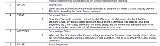

  • Maybe the CSTAT bit can be waited on?
  • You can do this as well; you can do second write on same location and can change some of the 1's which are not written with 0's on first iteration.
    Just been trying this, but I get the INVDAT (invalid data: 0->1 change) bit set. I'm writing all 0's, so the ECC part must be trying to write a 1 to a 0.
    It would seem then that this is a no-go.

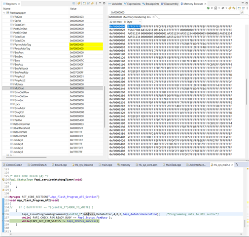

  • Attempting to write 0x00000000 to address 0xF000024
    Code is pretty much just the example code mentioned above

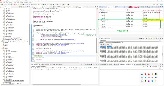

  • Hi Paul,
    I did test at my end, and it is working fine.

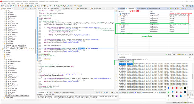

    On my first iteration i did this:
    I wrote 0xFEFEFE on location 0xF0000020.
    And then on my second iteration i wrote 0xFCFCFCFC on same location and which replaced my previous data 0xFEFEFE like as shown below:
    So, this means i can write more than one time on OTP section as well.
    Here is my write API code for your reference:
    And i am attaching my complete project for your reference:
    Customer_OTP_Write_Test_RM57x.zip
    Note: This time i tested on RM57x device because currently i don't have LC4357 board with me, the devices are very close to each other except some minor differences. So, please follow same pattern on your device as well.
