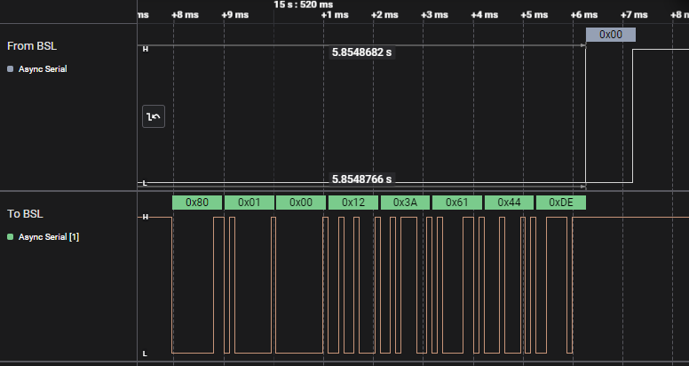

I am trying to do something that seems rather straight forward and simple, which is to invoke the ROM BSL and then to communicate with it UART0 @9600 baud rate.  I do this in the following steps:
Modify Syscfg for Configuration NVM (via empty project) for the following settings:
Enable BSL
Disable BSL Invoke Pin Check
Flash this empty Syscfg project via erase MAIN and NONMAIN memory
Flash my business logic firmware via erase MAIN memory
Invoke BSL in firmware for firmware update
Interact with invoked ROM BSL via firmware update software

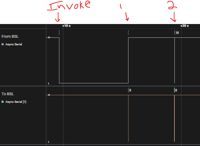

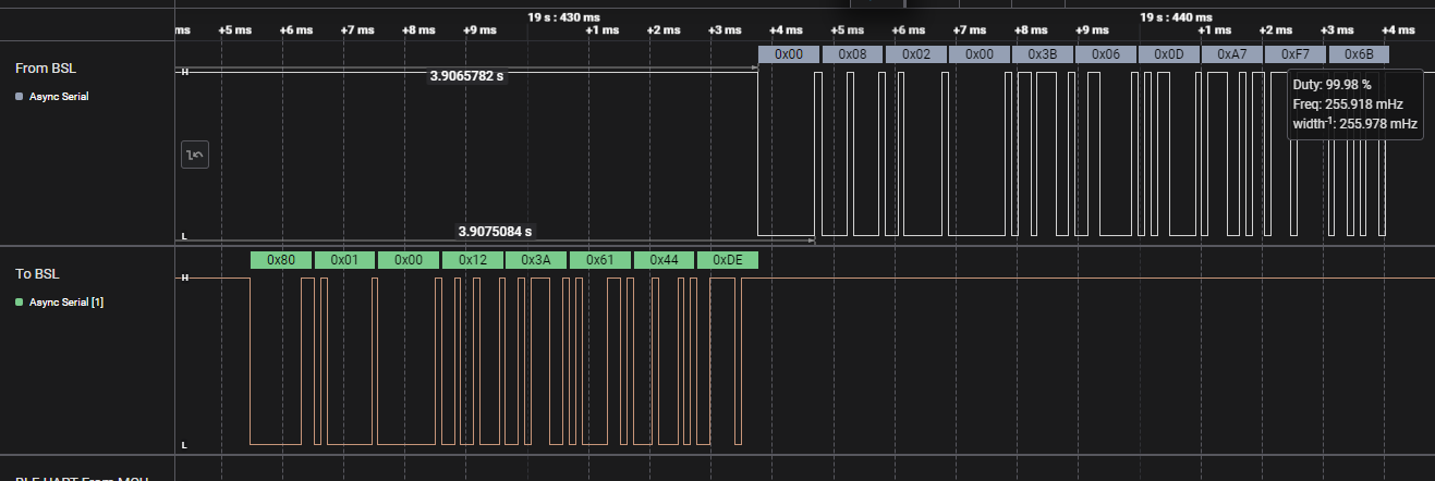

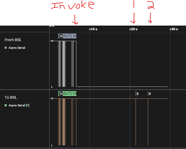

So the issue I am having is the UART BSL invoke example works just fine with the above steps.  I can connect and unlock the bootloader via my windows test BSL software.  However, copying the invoke function (invokeBSLAsm shown below) into my actual firmware seems to invoke the BSL but it does not respond to any commands.  I could really use some help here because I am absolutely stuck and don't know how to proceed.  I have studied the TI MSPM0 Bootloader document (slau887a.pdf).  I also attached analyzer captures of the UART to/from the BSL for both the working TI example and my failing application. A hint is that the "From BSL" line goes low at BSL invoke in the working example while it stays high in my not-working firmware.  Curiously, it seems to take two connect tries (labeled 1 and 2) to connect to the BSL in the working TI example, the first to "wake up" BSL and the second BSL connect command to get a response.  Please help as I am totally stuck.
<Successful UART BSL Invoke TI Example Project>
(zoomed out view to show invoke, connect 1 and connect 2>
(zoomed in at 1 and 2)
<Failed Invoke My Firmware Project>
