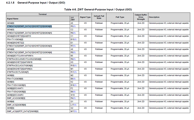

I am looking to see if a spreadsheet is available to easily identify/copy the pin assignments and functions for the TI TMS5704357BGWTEP for the pinouts?  thanks.
  • Hi Bernie,
    Unfortunately, we don't have any excel sheet for this. All you need to refer is "4 Terminal Configuration and Functions" chapter.
    Here you can find out peripheral wise pin assignments.
    For example section "4.2.1.8 General-Purpose Input / Output (GIO)", will provide information on where all the GPIO functions available.
    You can refer this one and then you can configure corresponding pins in HALCoGen PINMUX section.
