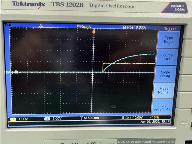

I am contacting you because a custom board built based on the AM6254 ALW package CPU is not working.
The main board that can be connected to this board for testing, and the MCU_RESETZ pin can be controlled via a push button on this board.
Currently, when the power is connected, I can see a 25MHz clock is working, but current consumption from the power supply and heat generated by the CPU itself, it is certain that it is not operating.
In addition, I check the RESETSTATZ pin on the main board, it remains fixed at LOW even after a reset, showing no movement at all.
I have attached the schematic for this custom board.
I look forward to your review of this schematic.
