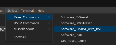

    One way to program this config would be to use the attached python script:
    1. Connect a CCS debug session
    2. Go to Scripts -> Reset Commands -> Software_SYSRST_with_BSL
    3. Once the device is in BSL mode, use the python script to flash the above non main config (make sure you do this within 10 seconds to avoid hitting the timeout in UART BSL)
    python bsl_cli_am13e2.py --no-invoke flash csc_exist_NM.txt

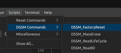

    If you want to factory reset/mass erase, the CCS20.50 contains some gel scripts for Mass Erase and Factory reset as well to erase configs.
    Shaunak
