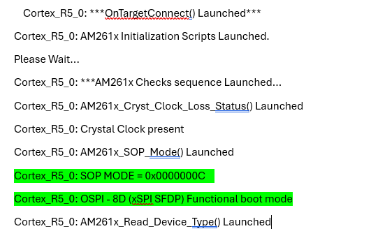

    1. Switch the boot mode pins to flash boot mode, i.e., OSPI/QSPI/xSPI. More details here, Or If your custom board has boot switches fixed, then proceed ahead
    2. Open CCS and follow the steps here:  Link. Once this is done, you will see GEL Output on the CIO console in CCS, verify that boot mode is a recognized boot mode like below:(Highlighted green colour)
    3. If it is not a valid boot mode, go back to schematic design and get the SOP pin connection fixed.
    4. If it is correct, then go to Step 3.

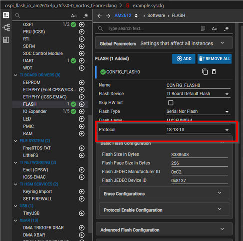

    2. Go to CCS, Import the project from SDK: AM261x MCU+ SDK: OSPI Flash IO
    3. Edit the syscfg and follow this guide to add custom flash support: AM261x MCU+ SDK: Adding Support For a Custom Flash Device.
    Make sure to disable the PHY mode and DMA mode when testing the OSPI flash IO example/ or during the first few test runs. These are needed if you run Flash at a higher speed, which is not recommended when you are starting to add the new Flash support. Also, it's always recommended to start from 1s-1s-1s protocol, then move up to 1s-1s-4s, and then to 1s-1s-8s, then 8s-8s-8s(*s should be used only when you are using OSPI flash). If you are using QSPI flash, then go up to 4s only.

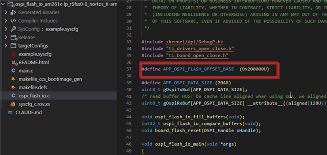

    Depending on the flash you are using, you need to adjust the flash offset in the ospi_flash_io.c file in the CCS project:
    You do not need to follow point 3 if you are using the same flash as the launchpad(AM261x-LP Rev A).

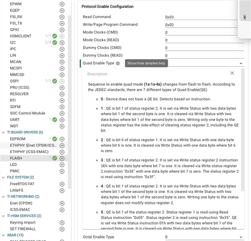

    **4s mode or QSPI mode requires enabling the QE bit, which is mostly non voltile in most flash, manufacturer does not set it, you will need to set it, if you want to use QSPI mode, this can be set using OSPI flash io example, by setting the QE configuration in the syscfg, refer to QE bit in flash datasheet for the QE mode:
