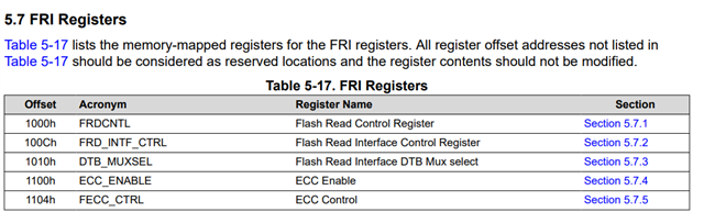

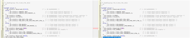

Stucture FRI_FLASH_CTRL_REGS_Regs has wrong ofset.
__IO uint32_t ECC_ENABLE - register shall be offset with 0x1100, but is shifted with 0x1104.
Quick fix:
__IO uint32_t Reserved_2[59];
Part Number: MSPM33-SDK
Quick fix:

Hello Erik,
The structure "FRI_FLASH_CTRL_REGS_Regs" is inside the file hw_fri.h line 98.
Kostadin

I just checked I do believe the ECC_Enable register should be 1100h
What's the specific issue you ran into that may have caused this?
