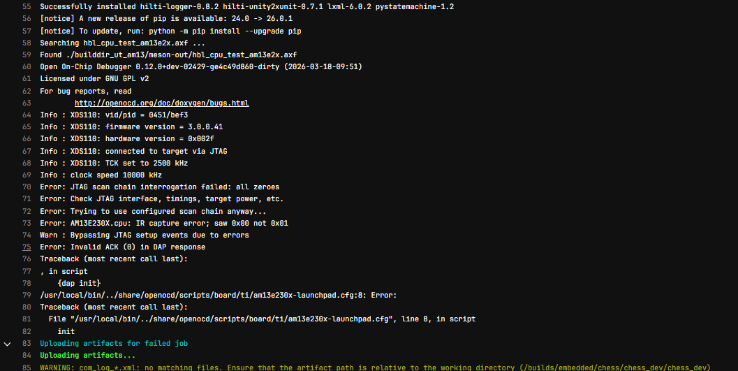

We are using https://github.com/TexasInstruments/asm-hal_ti/blob/master/am13/openocd_am13e230x_support.patch in our CI/CD.
Sometime the pipeline is successful. While most of the time we get following error

Hi Aafiya Asad,
Could you share the launchpad revision you are using?
I applied the patch to openocd commit e4c49d8 to match your build, but could not reproduce the error on both launchpad revisions. Could you share what you see in the success case?

hi Sameer Srivastava we had a look on our issue. so far we found out that the issue is related to a test application which utilizes some jtag pins as we expected that only the swd pins are used. it look the integrated flashing of the ccs is using swd instead of jtag, thats why we could not see the issue locally compared to ci/cd which is using openocd. can you confirm this? for now we excluded that pins from the test as a workaround. is there another option to overcome that issue, like connect under reset (to ensure default pin configuration)? what command would we have to use to avoid that problem in case pins are using alternative functionality?

Hi Norbert Daser , yes, our OpenOCD config for this device currently only uses JTAG, so the workaround you mentioned is correct, and it could also explain the earlier behavior.
You can try editing tcl/target/ti/am13e230x.cfg to use SWD to see if it solves the problem:
line 21: -transport select jtag +transport select swd line 25: -jtag newtap $_CHIPNAME cpu -irlen 4 -expected-id $_DAP_TAPID +swd newdap $_CHIPNAME cpu -enable
We'll evaluate if SWD support is on par with JTAG and update the patch.

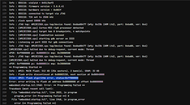

Hi Sameer Srivastava , with our workaround, sometimes we get an error as follows
This error is possible even when we use swd for flashing. is there any option of mass erase ( or something like mspm0_factory_reset that we have in mspm0)
Hi Aafiya,
Right now we do not have that support inside OpenOCD added, we do have gel script support in CCS for factory reset. We are still scoping in the support requests from different customers and will get back soon.

Hi Aafiya, Norbert,
Please find attached the updated file which will help enable Factory reset and Mass erase feature:
Place this at: openocd/tcl/target/ti/
We are also working on other features such as, which should be available in July (SoftwareSYSreset, Software_BOOTreset, Software_POR)
