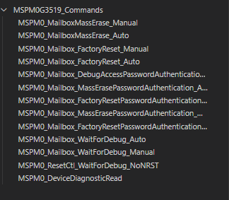

    1. How to open a projectless debug session: right-click on the .ccxml file in workspace->project->targetconfigs
    2. How to view all available device scripts: click on the scripts tab at the top of the IDE
    3. How to add GEL console View: Go to View->Console->GEL Output
    4. Running Diagnostic read script:

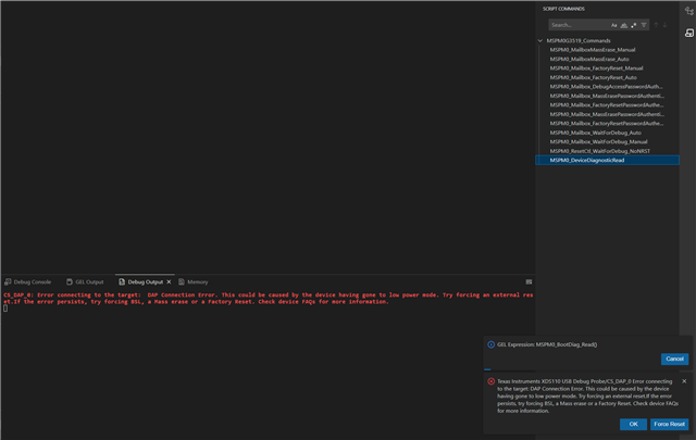

  • Hi Brian,
    The VCORE waveform looks like this:
    Thanks for the detailed step-by-step guide.
    If I follow the steps I directly see an error message when starting the diagnostic script:

  • Hi Timo,
    From the tests you have performed and the errors you are seeing, The team expert an I believe Non-Main is likely to have been erased. This makes the device unrecoverable by any means unfortunately.
    Brian
