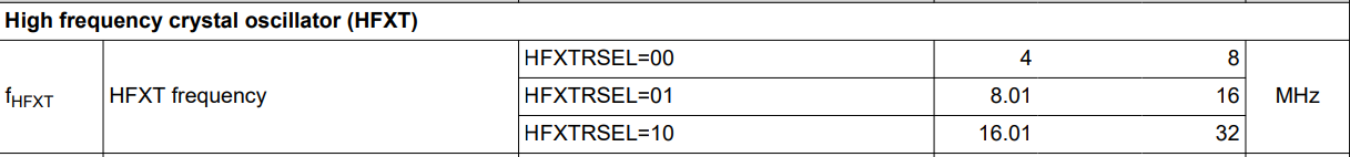

I would like to confirm acceptable minimum frequency for sysosc of MSPM0L1227.

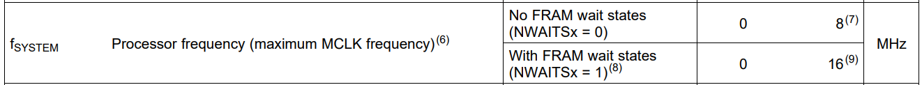

As a comparison, there is following spec on datasheet of MSP430FR5869.
This shows user can input approx 0 MHz and use as system clock.
On the other hand, according to datasheet and TRM of L1227, there is following spec.
From above, it seems that user can NOT set system clock lower than 4MHz.
Q1, Is my understanding correct ?
Q2, If above is "yes", is there any other M0 series which accept lower than 4MHz ?
we would like to realize lowest power consumption as possible as we can like MSP430.

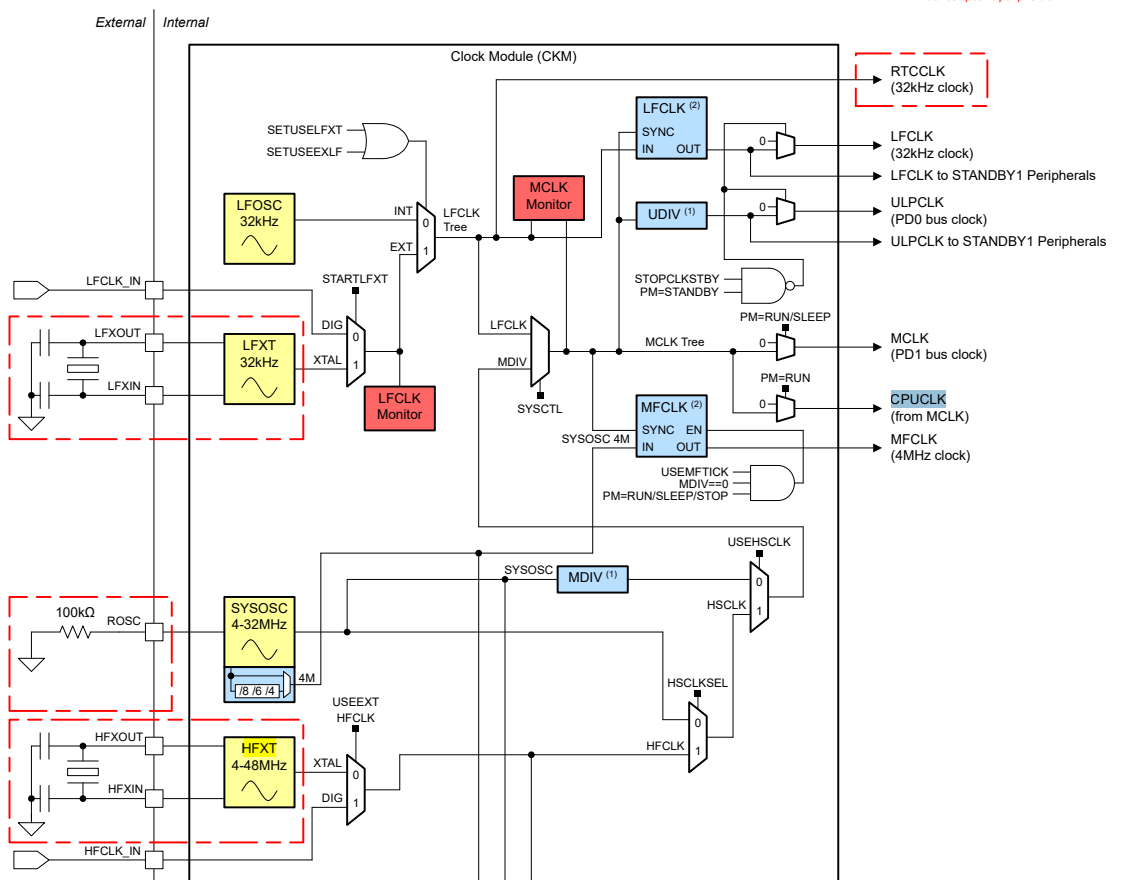

  • Yes, for the internal high speed clock source  SYSOSC, it's frequency can't be lower than 4MHz, but MCLK used by CPU, it can lower than 4MHz, for example you can use the LFCLK as MCLK's clock source.
    When user use "LFCLK" as CPUCLK, it seems that user can set only 32.768kHz. Is it impossible to apply other frequency like 1MHz which is defined in MSP430 datasheet ?

  • When user use "LFCLK" as CPUCLK, it seems that user can set only 32.768kHz. Is it impossible to apply other frequency like 1MHz which is defined in MSP430 datasheet ?
    No, it just can used to 32k
