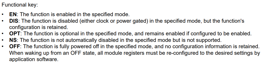

I'm confusing meaning of "OPT" which is described in "Supported Functionality by Operating Mode" of datasheet.
According to section "8.3 Operating Modes " of datasheet, "PD1" is defined as shown below.
""PD1" is always powered in RUN and SLEEP modes, but it disabled in all other modes."
On the other hand, there is following description in "Table 8-1. Supported Functionality by Operating Mode "
According to description of each term, it seems that above should be "DIS" not "OPT".
Question : Could you please tell me why "PD1" is NOT defined as "DIS"(disabled) for "STOP" and "STANDBY" mode ?
