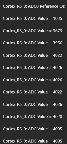

We were debugging the ADC channel AM263p control card (PROC159B(001)) with the potentiometer in the docking station(TMDSHSECDOCK-AM263). But we're not getting the desired result in the ADC counts, If I vary from 0V to 2.2V value getting 4095 value.image.png I've attached the result below:
Suggest a way to get the result.

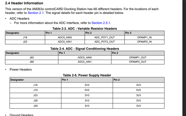

  • Hi Aravind,
    My previous comment is still exist. Please first verify the ADC reference switch settings on the AM263Px control card.
    The AM263Px MCU+ SDK ADC examples are intended to run with the 1.8-V reference path, and the docking-station potentiometer is derived from 3.3 V. If the ADC input goes above the selected ADC reference voltage, the conversion result will saturate at 4095, which matches the behavior you are seeing.
    For ADC0_AIN0:
    J18 pins 1-2 = potentiometer directly to ADC input
    J18 pins 2-3 + J65 pins 1-2 = potentiometer through op-amp path
    Masoud

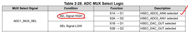

  • Hi Aravind,
    There is one more thing we need to take care for ADC0_AIN0. This channel has been muxed with DAC output:
    You'll have to push the "SEL" pin to HIGH to access ADC0_IN0:
    You can use SysConfig to automatically generate the initialization for I2C and IO expander TCA6424ARGJR.
    Masoud
  • Hi Masoud,
    Thanks for your response. As per the below image, I2C configuration only I2C0 needs to be selected, but the I2C Instance is I2C2 (Value was locked by CONFIG_IOEXP0) is present. So needs to change here anything in the configuration or it will work as it is??
    Thanks & regards,
    Aravind R
  • Yes, I2C2 is correct one.
