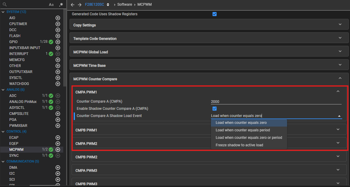

The main question is, whether the Event Trigger Submodule in MCPWM provides the same functionality like the Repetition Counter in STM32G4. For instance, with the Repetition Counter and Preloading mechanism in STM32G4, it is possible to create different periods of Shadow Loading points for the CCRx, for instance at every 2nd-3rd-4th Counter event etc. I was wondering if the same can be achieved with Event Trigger Submodule in MCPWM. From what it can be seen, it looks like it is not possible since the selection of events does not include the repetition counter wise functionality:

    Shadow register loading for the counter-compare registers (PWMx_CMPA, PWMx_CMPB, CMPC, CMPD) is governed by the CMPCTL[PWMx_LOADAMODE] / CMPCTL[PWMx_LOADBMODE] register bits, and is limited to three fixed hardware events:
    Load Mode Trigger Condition
    CTR = Zero Time-base counter reaches 0x0000
    CTR = PRD Time-base counter reaches TBPRD
    CTR = Zero or PRD Either of the above
    There is no hardware mechanism to skip loading cycles — you cannot configure shadow loading to occur at every 2nd, 3rd, or 4th counter event as the STM32G4 Repetition Counter enables.
