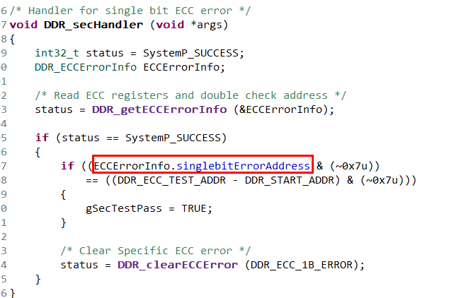

Question 1:
The problem encountered is that we can trigger ECC normally from 0x8000_0000 to 0x8000_0007
Exception 0x8000_0008 to 0x8000_0001F
0x8000_0020 to 0x8000_00027 return to normal. The subsequent addresses follow the same pattern.
Debugging findings: When injected into the address 0 x8000_0000 ~ 0 x8000_0001f, ECCErrorInfo. SinglebitErrorAddress value is always 0, singlebitErrorCount becomes 1, This 8-byte alignment judgment will affect the results from 0x8000_0008 to 0x8000_001F. Does this judgment not take all scenarios into account? How can it be modified?
  • I think the reason is that there is a bug here: each bit in the register corresponds to 8 bytes, so it should be "* 8" (or "<< 3u") instead of  "<< 1u".
  • Hi Nihar,
    Customer changed it to <<3 and get right result. Please help to confirm, if it is right, suggest file a jira to update in next release.
