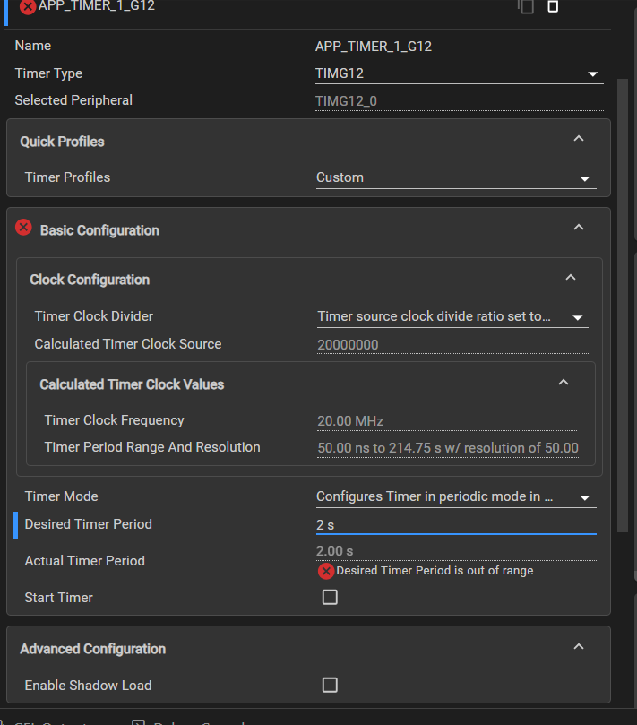

Hi, I am trying to configure the Timer12 and found few descripencies.
  1. The timer period configuration shows error. It seems like Sysconfig considers Tim12 as 24 bit but it is 32 bit. Please have a look at the screenshot from Sysconfig
  2. Option is missing for configuring in "Free running mode" where I want to counter for update freely ( 0xFFFFFFFE -> 0xFFFFFFFF -> 0x0 -> 0x01 ) and provide me interrupt on counter overflow. Right now i can only select timer period in time units. It would be great if I can configure in hex values (corresponding to ticks) also.
Feature Request in Sysconfig : It would be good if there is a straight forward way to disable sysconfig so that the autogenerated files can be manually edited.

  • Hi Dheeraj,
    I see there was a bug in the sysconfig js file which was causing issues w.r.t to timer12 period setting. We have fixed it.
    Please use the updated file below and replace it at: mcu_sdk/source/.meta/drivers/timer/v0/timer.syscfg.js

    function onChangeTimerProfile(inst, ui) {
        if(inst.profile !== "CUSTOM") {
            // matches name shorthand
            let selectedProfile = _.filter(TimerProfiles, ['name', inst.profile]);
            if(selectedProfile.length === 1){
                // assigns the empty profile with the selected profile on top
                Object.assign(inst, EmptyTimerProfile,

    function getTimerClockSourceFreq(inst) {
        let timerClockFreq = common.getBUSCLKFreq("TIMER");
        timerClockFreq = timerClockFreq / inst.timerClkDiv.slice(-1);
        return timerClockFreq;
    function getTimerClockFreq(inst,ui)
        let timerClkFreq = common.getBUSCLKFreq("TIMER");;
        let timerDivider = inst.timerClkDiv.slice(-1);
        let timerPrescaler;
        if(isHighResolutionCapable(inst)){
            timerPrescaler = 1;
        }else{
            timerPrescaler = (inst.timerClkPrescale);
        timerClkFreq = (timerClkFreq / (timerDivider * timerPrescaler));
        return timerClkFreq;
    function getTimerClockFreqStr(inst,ui)
        let freq = getTimerClockFreq(inst,ui);
        let freqStr = common.getUnitPrefix(freq);
        return freqStr.str + "Hz";
    function getTimerPeriodRangeStr(inst,ui)
        let bitRes;
        let minPeriod;
        let maxPeriod;
        let maxPeriodScaled;
        let maxPeriodVal;
        let maxPeriodUnits;
        let resolution;
        let timerFreq;
        timerFreq = getTimerClockFreq(inst,ui);
        bitRes = getTimerCountBitRes(inst,ui);
        resolution = minPeriod = common.getUnitPrefix( 1 / timerFreq);
        if(inst.timerMode.includes("UP_DOWN")){
            maxPeriod  = 2*Math.pow(2,bitRes) / timerFreq;
        }else{
            maxPeriod  = (Math.pow(2,bitRes) / timerFreq);
        maxPeriodScaled = getScaledPeriod(maxPeriod);
        maxPeriodVal = maxPeriodScaled[0];
        maxPeriodUnits = maxPeriodScaled[1];
        let str = minPeriod.str + "s to " + maxPeriodVal + maxPeriodUnits + "w/ resolution of " + resolution.str + "s";
        return str;
    function isHighResolutionCapable(inst)
        return (inst.timerType == "TIMG12")
    function getTimerCountBitRes(inst,ui)
        let bitRes;
            bitRes = 32;
        }else{
            bitRes = 16;
        return bitRes;

    function getActualTimerPeriodTicks(inst)
        let desiredPeriod = common.parseFloatUnitInput(inst.timerPeriod,"s");
        if(desiredPeriod === NaN){
            return "NaN";
        let timerFreq = getTimerClockFreq(inst);
            desiredPeriod = desiredPeriod / 2;
        }else{
            desiredPeriod = desiredPeriod;
        return (Math.round(desiredPeriod * timerFreq));
    function getActualTimerPeriod(inst)
        let maxTimerTicks = Math.pow(2,getTimerCountBitRes(inst));
        let timerMode = inst.timerMode
        let timerTicks;
        let actualStr;
        timerTicks = getActualTimerPeriodTicks(inst);
        if(timerMode.includes("UP_DOWN"))
            maxTimerTicks = 2*maxTimerTicks;
        }else{
            maxTimerTicks = maxTimerTicks;
        if(timerTicks > maxTimerTicks)
            actualStr = 'Desired Timer Period is out of range'
        }else{
            let result = getScaledPeriod(timerTicks / timerFreq);
            actualStr = result[0] + result[1];
        return actualStr;

    function validate(inst, validation)
        if(inst.timerPeriodActual == 'Desired Timer Period is out of range')
            validation.logError("Desired Timer Period is out of range", inst, "timerPeriodActual")

    • Option is missing for configuring in "Free running mode" where I want to counter for update freely ( 0xFFFFFFFE -> 0xFFFFFFFF -> 0x0 -> 0x01 ) and provide me interrupt on counter overflow. Right now i can only select timer period in time units. It would be great if I can configure in hex values (corresponding to ticks) also.
    That would be the periodic Up counter mode. You can check the different interrupt settings in the same sysconfig window. Based on the example ( 0xFFFFFFFE -> 0xFFFFFFFF -> 0x0 -> 0x01 ) , the counter would wrap around and you can get the interrupt at counter=0.
    I will share this feedback with the team.

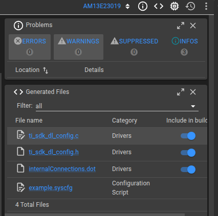

    You can generate the file once for reference, disable the file build using the blue radio-button, but then you will have to manually create a new file, compile it with example, copy the reference code and modify it.
