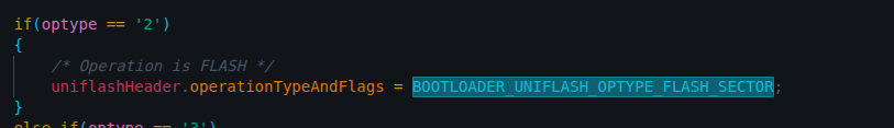

    ③ It uses block writing, but I want sector writing (write to 0x81000)
    In this case, I intend to write the software starting from FLASH address 0x60081000.
    However, the sample code uses block-based writing rather than sector-based writing, so it cannot be written as intended.
    (It seems that only 0x0 or 0x020000 can be specified.)
    Is there any sample code that supports sector-based writing?
    May I know what is the operationTypeAndFlags used in thie case. There is the BOOTLOADER_UNIFLASH_OPTYPE_FLASH_SECTOR paramater present
