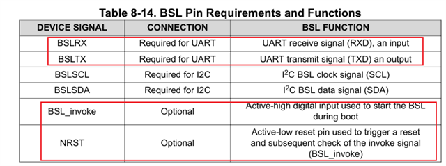

    We do support ROM BSL which is a factory bootloader.
    If you're choosing BSL to flash the MCU, then please reserve below pins:
    For details, you can refer to datasheet: MSPM0L130x Mixed-Signal Microcontrollers datasheet (Rev. D)
