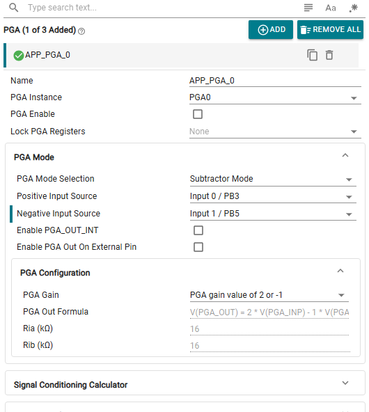

When configuring PGA as "Subtractor Mode", sysconfig generates an wrong code.
For example, when adding an PGA configuration like the below with "C:\ti\am13e230x_sdk_26_00_00_06\examples\driverlib\gpio\gpio_toggle_output"  example code,

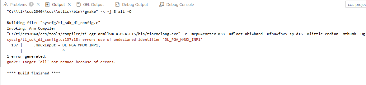

the below error is generated.

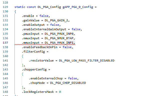

The below is generated code,
DL_PGA_MMUX_INP1 should be INM1.
