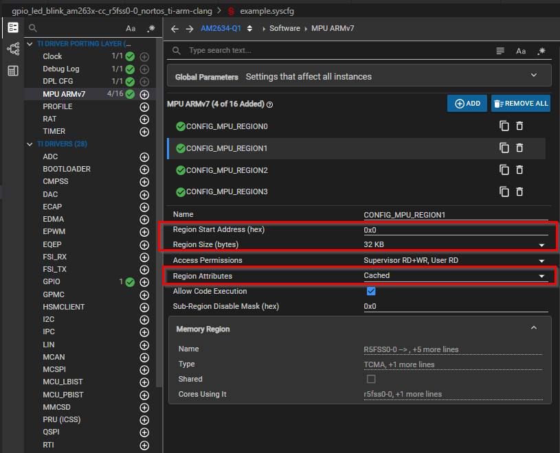

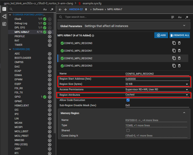

In examples in AM2634 SDK, TCM is set to cached in MPU settings, as shown below.

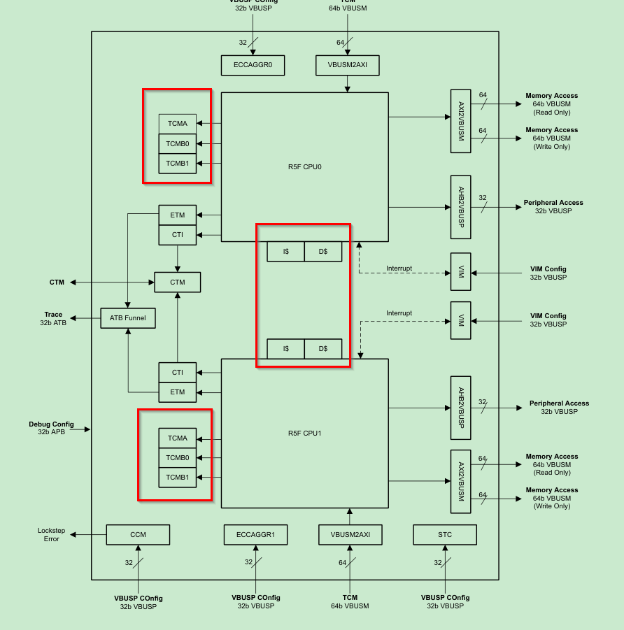

In the block diagram in TRM, it is shown as below. TCM, as tightly coupled memory, is not accessed through caches, that it should not be set to cached in MPU.
Please help to explain why TCM is set to cached in SDK examples. Thanks.
