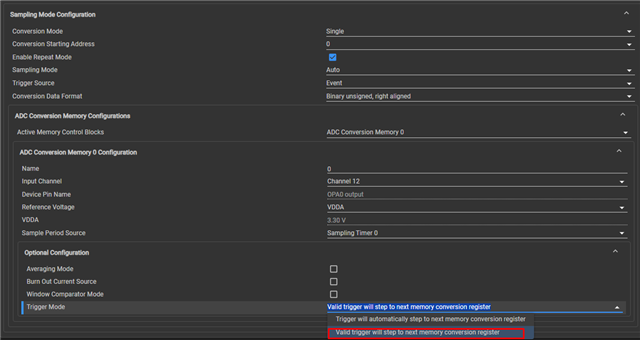

When using the event trigger from a timer, if I set the SAMPMODE (CTL1 bit 20) bit to AUTO, when the ADC gets the trigger signal it samples the ADC forever, never stopping conversions.  It does not do it once every trigger event.  If I set the bit to MANUAL, the trigger only happens at the first EVENT, nvere triggering again.  What's a mother to do?  Here is my setup configuration:

    DL_ADC12_initSingleSample(ADC12_0_INST,
                                DL_ADC12_REPEAT_MODE_ENABLED,
                                DL_ADC12_SAMPLING_SOURCE_AUTO,
                                ADC12_CTL1_TRIGSRC_EVENT,
                                DL_ADC12_SAMP_CONV_RES_12_BIT,          //12 bit resolution
                                DL_ADC12_SAMP_CONV_DATA_FORMAT_UNSIGNED);
    DL_ADC12_configConversionMem(ADC12_0_INST,
                                ADC12_0_ADCMEM_0,
                                DL_ADC12_INPUT_CHAN_1,     /*DL_ADC_INPUT_CHAN_x - sets x as ADC ch.*/
                                DL_ADC12_REFERENCE_VOLTAGE_INTREF,
                                DL_ADC12_SAMPLE_TIMER_SOURCE_SCOMP0,
                                DL_ADC12_AVERAGING_MODE_DISABLED,
                                DL_ADC12_BURN_OUT_SOURCE_DISABLED,
                                DL_ADC12_TRIG_SRC_EVENT,    // 1 = hardware = Event trigger
                                DL_ADC12_WINDOWS_COMP_MODE_DISABLED);
