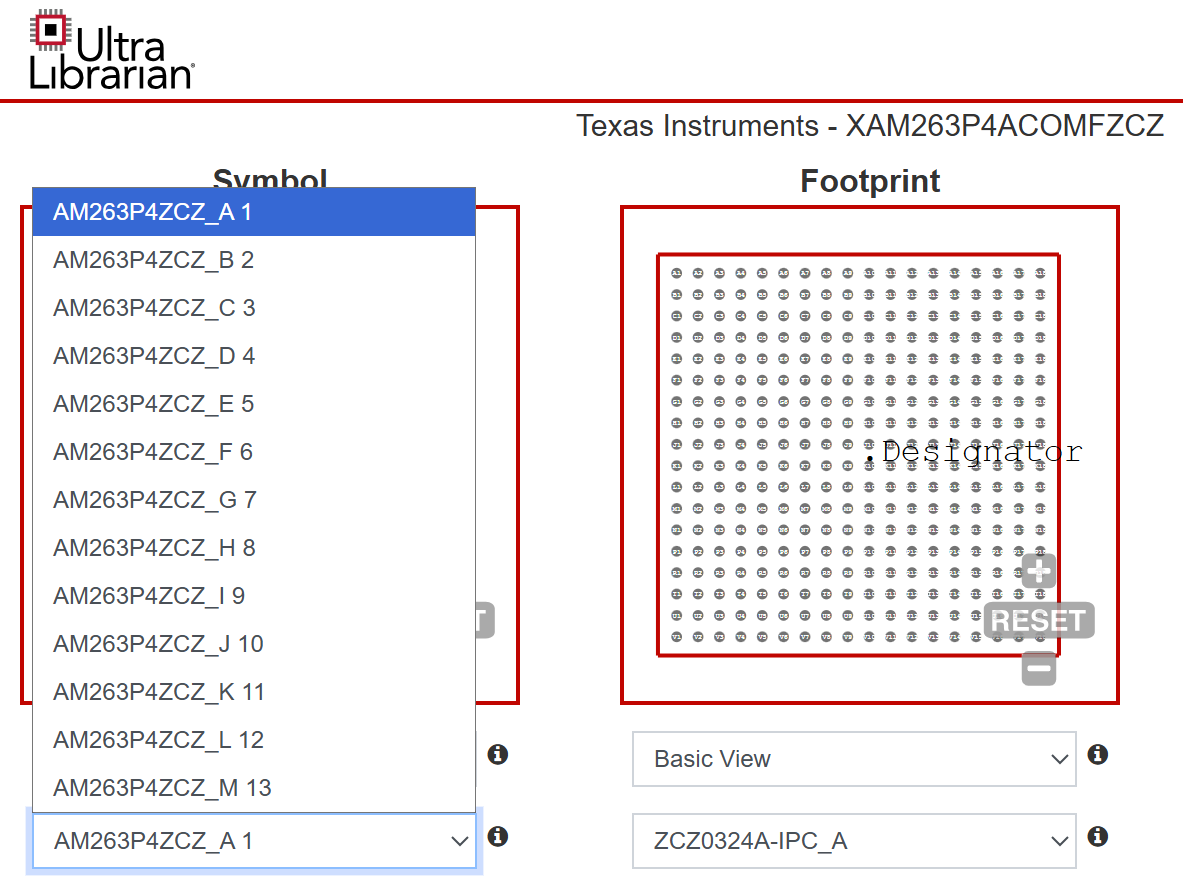

When looking at the ultra librarian download options, I see the following:
These do not appear to cleanly map on to the device nomenclature in the datasheet. The footprint options are similarly confusing. How do the symbols/footprints provided map to the devices my customer is interested in? Which options should I select to have the correct symbol/footprint for the above OPNs?

  • Sam,
    It looks like the UltraLibrarian symbol is just for the AM263P4x(compatible package) device.
    I will have the additional packages created by the internal CAD team.
    Brennan

    A couple follow up questions:
    • Why are there so many symbol options for the C variant?
      • Clicking through the options, it seems like each one has different peripheral sets (A has ADCs, B has JTAG, C is clocking and RSTs, etc). However, no option seems to include all pins on the device. Is this typical for devices over a given number of pins? I see Jacinto does something similar w/ their 1000+ pins, but MSPM0 fits ~100 pins on one symbol
    • What would the timeframe be for adding the symbols for other variants?
    Sam
    For larger packages/BGA packages the TI CAD team will almost always split up the component into different symbols (unless specified otherwise). This helps with organizing circuits and peripherals within the schematic.
    I would anticipate ~1 week for the CAD team to create the symbol and get approval from the product line.
    Brennan
  • Great, thank you! Will be in touch around then.
    I see the reasoning behind the symbol splitting. If that is the case, is there any way to make the dropdown menu have clearer options? The alphabetical A-M is pretty abstract, and having clear names for the variant + what peripherals/pins are included in a given symbol would be handy.
    [EDIT] disregard above, I was being stupid and didn't hover over the info pop-up that explicitly states they are split for the reason you stated and that all symbols are downloaded at once (and not piecemeal like I thought)
