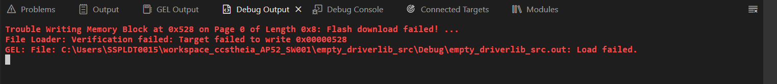

I want to use the external Jlink debugger to flash and debug my project without using on board TI XDS Debugger.
After creating my project, I have changed the debugger option,
When I debug (F5) the project, I am getting the below error,
Sakhan

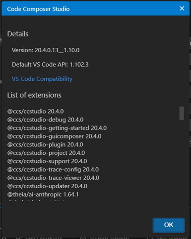

  • Hi Sakhan,
    Which CCS version you are using? I tried in CCS 20.5 and it works well.

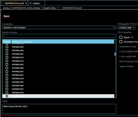

    I see you might miss below step:
    Modify CCXML file to J-Link.

  • Hi Sal,
    I modified the Debugger option in Project Properties and the same reflected in the CCXML file.
    I am using CCS version,
    I am getting the same error as mentioned above,
    Sakhan

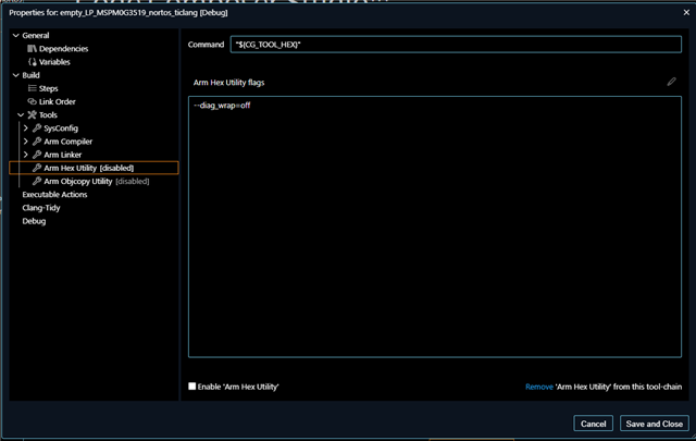

  • Hi Sakhan,
    Do you modify the HEX output? If so, there need additional alignment for the output.
    If you does not modify it, I recommend you install the latest CCS version and take a try, and please click on SEGGER JLINK support if there has an option. I remember it requires additional click on button in CCS12, not sure whether it is also required in CCS20.
