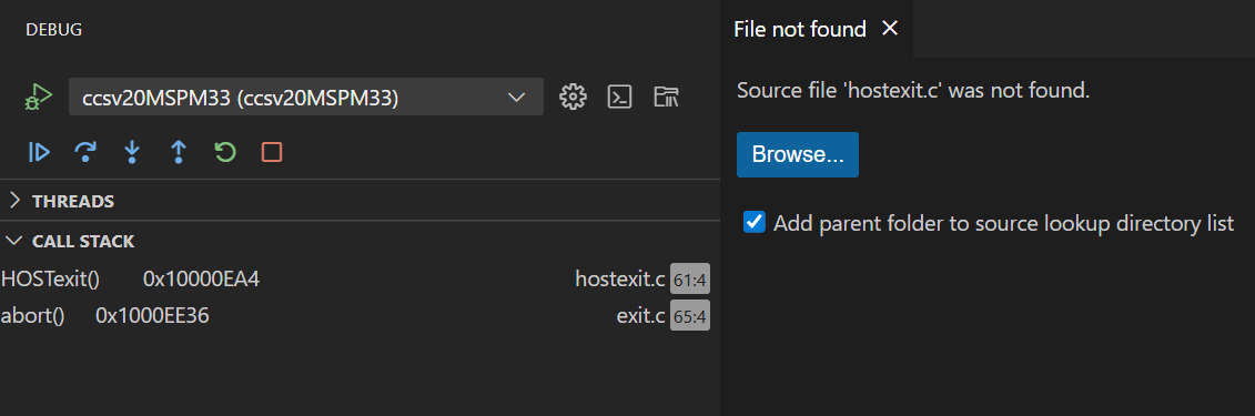

Part Number: MSPM33-SDK
When debugging my project CCS appear File not found window .What does it mean?
CCS version : 20.5.0.28__1.11.0
MSPM33 SDK version : 1.3.0
I believe this just means the the example has exited. So if there's no while loop at the end or break point it will just end.
