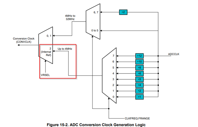

  • Hi Holger,
    After confirmed with internal team, if users select internal reference mode for ADC, we will automatically limits the CONVCLK to smaller than 4MHz. Then the VREF will be good for ADC sampling.
    So, users don't need take the VREF setting time when using VREF with ADC. The overall sampling rate is automatically limited by ADC internal clock process.
    B.R.

  • Hi Sal,
    That's interesting.However, their measurements show that the CONVCLK apparently runs at 32 MHz. CLKFREQ.FRANGE is definitely set to 5 (>24 to 32 MHz / divide by 8) and VRSEL is set to 2h (internal reference). What could be the reason?
    With the current settings, however, it works well. In fact, if the CONVCLK needs to run at 4 MHz, they would have to either adjust the input filter or in the worst case go to an external reference or the MSPM0G1228.
    • ADCCLK used for both sampling and conversion -> sourced from 32MHz ULPCLK
    • tsync = 0, since ULPCLK is used
    • Sample window:
      • Generated with SAMPCLK, sourced from ADCCLK using SCLKDIV (is set to 0 -> Do not divide/divide by 1) -> 32MHz
      • SCOMP0 VAL is set to 146. -> number of sample clocks = VAL x SCLKDIV -> still 146 clock cycles
    • Conversion window:
      • Generated with CONVCLK, sourced from ADCCLK using VRSEL and CLKFREQ -> The CONVCLK frequency is not to exceed 4MHz when using the internal VREF. Since the ADCCLK is set to 32 MHz, CLKFREQ.FRANGE is set to 5 (>24 to 32 MHz), which applies the :8 divider, according to Figure 15-2, generating those 4 MHz.
    • Overall time:
      • Sample window: 146 clock cycles @ 32 MHz
      • Conversion window: 14 clock cycles @ 4 MHz -> 14*8 = 112 clock cycles @ 32 MHz
      • Overall: 146+112 = 258 clock cycles @ 32 MHz -> 8.06 us -> 03 ksps
      • 4-Oversampling -> 8.06 *4 = 32.25 us
      • 9 Channels: 32.25*9 = 3 us
    • However, I am measuring 2 us, which matches with the following calculation, assuming a CONVCLK of 32 MHz:
      • Conversion window: 14 clock cycles @ 32 MHz
      • Overall: 146+14 = 160 clock cycles @ 32 MHz -> 5.00 us -> 200 ksps
      • 4-Oversampling -> 5.00*4 = 20.00 us
      • 9 Channels: 20.00 *9 = 00 us
    Regards, Holger

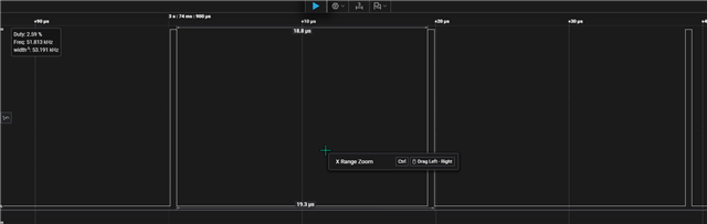

  • Hi Holger:
    Please ask customer for double check, I tested LP-MSPM0L2228 which match TRM description.
    Test code:
        while (1) {
            /* Low - High pulse represents sample+conversion time */
            /* 4 channel sampling:
             * Sample time = 1us
             * CONV time = 14* 1/4M = 3.5us (12-bit, 4MHz with internal clock; ulpclk/8=4MHz)
             * Total time per channel: 4.5us
             * Total time for 4 channels: 4.5us*4=18us
             * RIS assert time = 1/4M = 0.25us
             * Total time: 18.25us+ minus time (CPU write register time)
            DL_GPIO_clearPins(GPIO_LEDS_PORT, GPIO_LEDS_USER_LED_1_PIN);
            __NOP();
            DL_ADC12_startConversion(ADC12_0_INST);
            while(DL_ADC12_INTERRUPT_MEM3_RESULT_LOADED !=
                    DL_ADC12_getRawInterruptStatus(ADC12_0_INST, DL_ADC12_INTERRUPT_MEM3_RESULT_LOADED));
            DL_GPIO_setPins(GPIO_LEDS_PORT, GPIO_LEDS_USER_LED_1_PIN);
            __NOP();
    //        gCheckADC = false;
    //        adcResult = DL_ADC12_getMemResult(ADC12_0_INST, DL_ADC12_MEM_IDX_0);
            DL_ADC12_clearInterruptStatus(ADC12_0_INST, DL_ADC12_INTERRUPT_MEM3_RESULT_LOADED);
            DL_ADC12_enableConversions(ADC12_0_INST);
            __NOP();
    Test result:
    B.R.
    Sal
