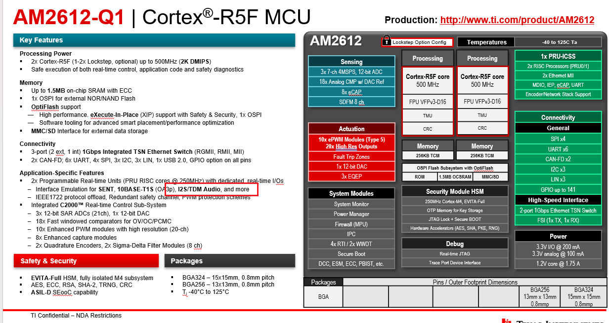

AM2612-Q1: Is PRU-ICSS support MCASP?
Part Number: AM2612-Q1
Hi team,
In our one-page, it shows PRU-ICSS support I2S, is it support MCASP?
BRs
Shuqing
  • Hi Shuqing,
    We don't have MCASP IP support on am261x but we emulate the IP through PRU-ICSS software based solution to support I2S/TDM engines.
    Rajul
  • Hi Rajul,
    thanks for your reply.
    I noticed your answer in other thread to list the TDM parameter can be supported using AM26x PRU-ICSS
    currently, my customer want to use PRU-ICSS to achieve the below TDM requirement, could you help to check if it can support in AM26x device?
    1. TDM in/out should use the external clock source from master
    2. TDM requirement is showed in below:
    TDM8(2xTDM8 data in + 2xTDM8 data out) or TDM16(1xTDM16 data in + 1xTDM16 data out), TDM RX/TX work in slave mode, should support DMA transfer
    BRs
    Shuqing
    BRs
    Shuqing
  • Hi Shuquing,
    Can you please confirm the BCLK and FSYNC clock rate for this configuration to access the feasibility better?
